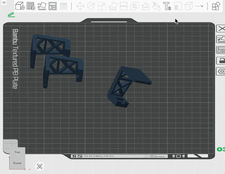

Perhaps the tool you are looking for is “Lay on Face” in the menus. I was confused by it at first, as it just drew some blobs on my things, so i ignored it. Eventually i went back and realized what I had missed:
Felt right sheepish, I did.
This tool only works on top-level objects, though – not child objects. I have to split them back to objects, do my alignments, then re-merge them. Kind of annoying. The slicer’s 3d modeling capabilities are better than none, but still pretty awful. ![]()

It’s there… Lay on face, the symbol is a box set at an angle with a curved arrow towards the plate, but without the word AUTO (there are two nearly identical)
Shortcut is F key
works on a selected object, and you need to click the surface you want on the plate
