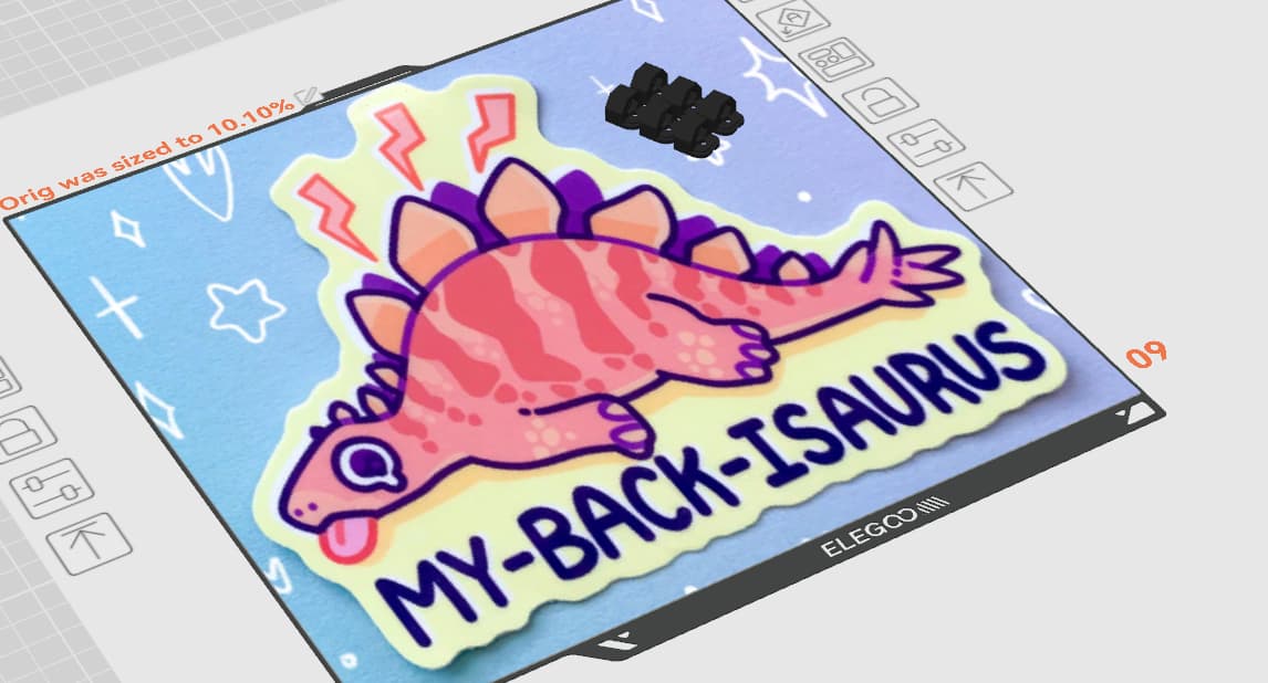

In Bambu Studio, can you the Bambu logo to the build plate? It doesn’t appear that all physical plates have the logo on them, I have a textured PEI plate with the logo and a smooth PEI plate without. Anyways, I use the textured plate the most and I don’t always print in the center and it would be good visual reference to where I need put the glue. Just a thought…

I may not have articulated what I meant well enough… It would be helpful if the software displayed the plate logo directly on the virtual build plate—similar to how it currently shows the ‘Plate Type’ and the ‘Nozzle Only’ exclusion zones. It would help know where and where not the glue is needed.

You get to do this yourself if you want
Machine → Printable Area → Texture → Upload
Give it a png
Ta-Da
right click, “center”.

It’s either Studio or OrcaSlicer. Works the same way in both slicers.
Create your own image as .png or .svg.

It took me a minute to find the location of the machine settings. In the below situation, I am printing by part instead of by layer, now I have better reference as to where to apply my sticky stuff.
