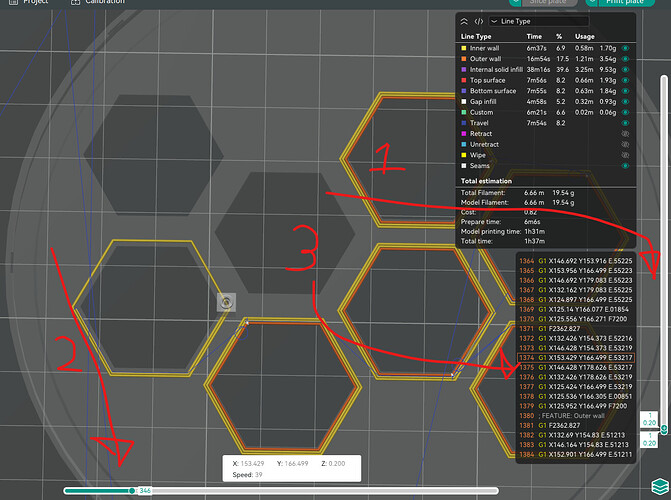

So I want to add in pauses in my gcode where the support interface is about to start, and when it ends, I think it happens twice within this gcode but I can’t find it because I don’t know gcode. I would love it if someone could help me out. The gcode is also too big to paste here, but I can provide the 3mf file for it.

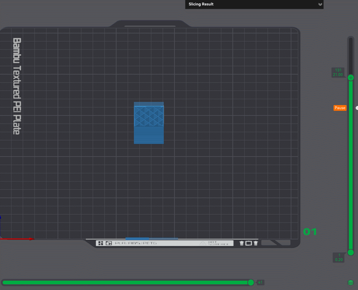

You don’t need to know gcode to insert a pause. You can do it in Bambu studio.
But that is a pause between layers, this is a pause during a layer to change the filament. If I did a layer pause, it would cause PLA to be printed where I need TPU, and I just need the PLA on the support interface
To put pauses inbetween actions WITHIN a layer, you will need to edit the gcode text file.
Research first in the slicer preview.
  1. Move the layer slider to the layer in question
  2. Move the timeline slider to the beginning of the first action you want to find
  3. Make a note of the LINE NUMBER in the gcode preview.
    Repeat 2+3
Get out your text editor (recommend: notepad++, enable line numbers)
Now that you know where the pauses need to be placed, you need to find the right pause command for your printer model/language. Probably M400 U1
Add those lines, save to SD/USB, walk it to your printer and go get it

I use Bambu Studio and the 3mf file doesn’t seem to like Orca Slicer so I can’t see the gcode on the side, and this was a file given to me by someone helping me with the model.
In Bambu Studio, use the bottom scroll bar to preview the gcode for the layer you are on. You can also use the left and right arrow keys to move the bar.

Bambu studio hides that box until you start derping with the timeline (#2) slider.
Orca leaves it up to pollute your UI till you turn it off in prefs. 6 of 1, half dozen of another :wink:
Ahh I see, then it’s just figuring out the right thing to insert into the gcode to get the printer to pause as if it were a user prompted pause
I believe it is the M400 U1 command so I’m going with that
