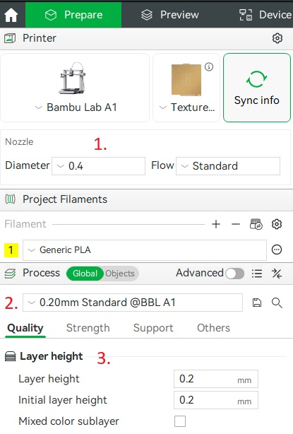

Honestly, I don’t think @MalcTheOracle is wrong on this.
Now, correct me if I’m wrong here:
  1. This determines the size of the filament thread coming out of the nozzle port (0.4 mm).
  2. this determines the base layer height by:
    1. Z-axis movement (Toolhead Speed)
    2. controlled extrusion rate (Flow Rate) is determined by:
      1. Flow Temperature (Tf)
        1. Example: PLA
          1. Tg = Glass Point ~60c (PLA becomes soft)
          2. Tm = Melt Point ~ 150c - 180c (PLA beings to melt but does not have sufficient radiant heat to melt prior layer enabling bonding)
          3. Tf = Flow Temperature ~ 200c - 220c (PLA reaches viscus liquid state and can be run though the nozzle without impedance. At this temperature PLA has enough radiant to melt the contact point of the prior layer resulting in bonding as soon as the cooling fan passes over.)
  3. This can change the layer height thus adjusting how the slicer does the all of the prior calculations.
To change the flow/speed/temperature calculations would have to be done at the exact moment where the nozzle switch needed to occur and it would have to be programed in prior to slicing the model into Gcode.
I believe what MalctheOracle is saying is that current slicer models do not have that ability.

If you truly are wanting to switch a .4 nozzle to a .2 midway, you’d need to be incredibly careful in your gcode. You’d probably need to slice the object twice, with each nozzle, and make some sort of frankenstein stitched together gcode, and hope that all the static config setup for the 0.4nozzle start doesn’t interfere once you have the 0.2 one. This is a bad plan. Software needs to support this
