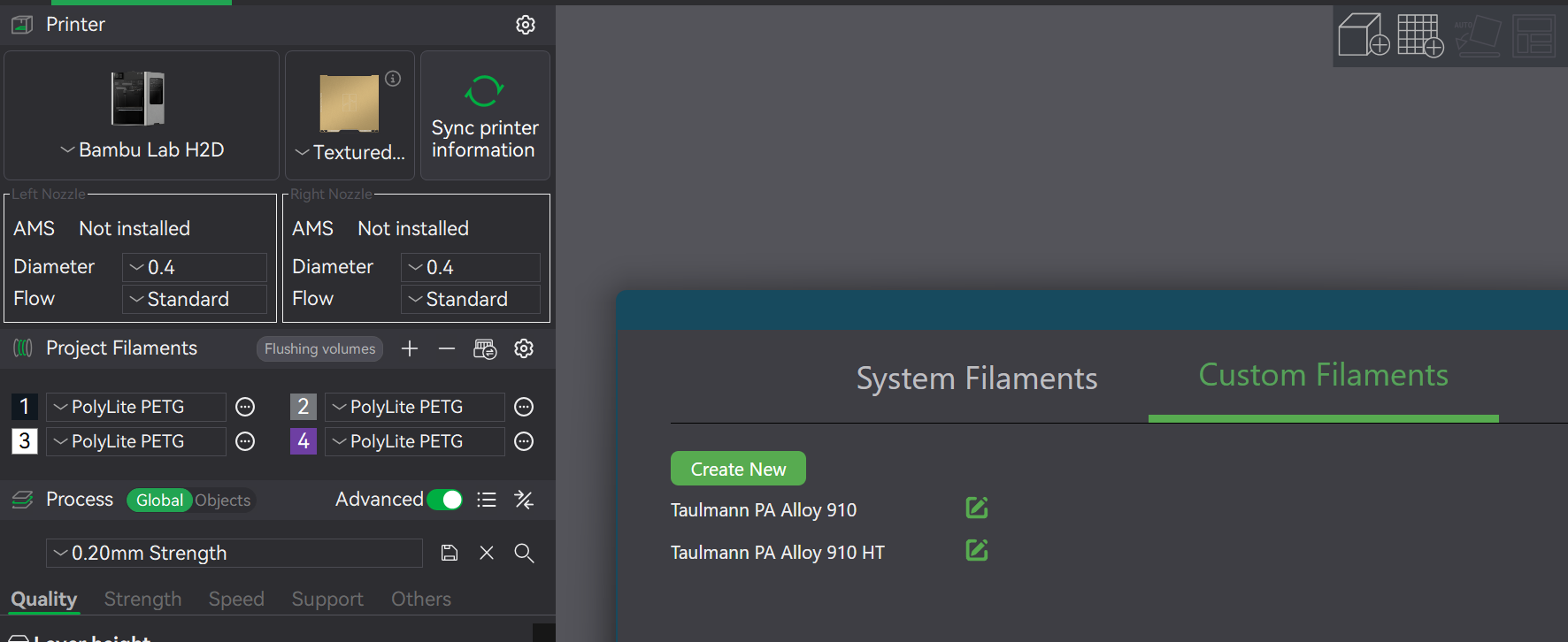

Been having the issue on my bambu slicer to add a sainsmart tpu profile from makerworld to the h2d list. It will add the filament profile to my a1 and mini screen, but it wont show up in my h2d selection. Is there something I need to do different for the h2d in the slicer to add a new filament profile? even importing the json isnt working…

Syncing custom filaments to printer has been weird for forever, I’m also looking forward to a universal solution… But usually just reuse the bambu profile works :slight_smile: and you can finetune it better…
I would assume it’s because Sainsmart has not yet added H2D profiles?
To get a filament profile to show up on the H2D screen, you have to create the filament here:
