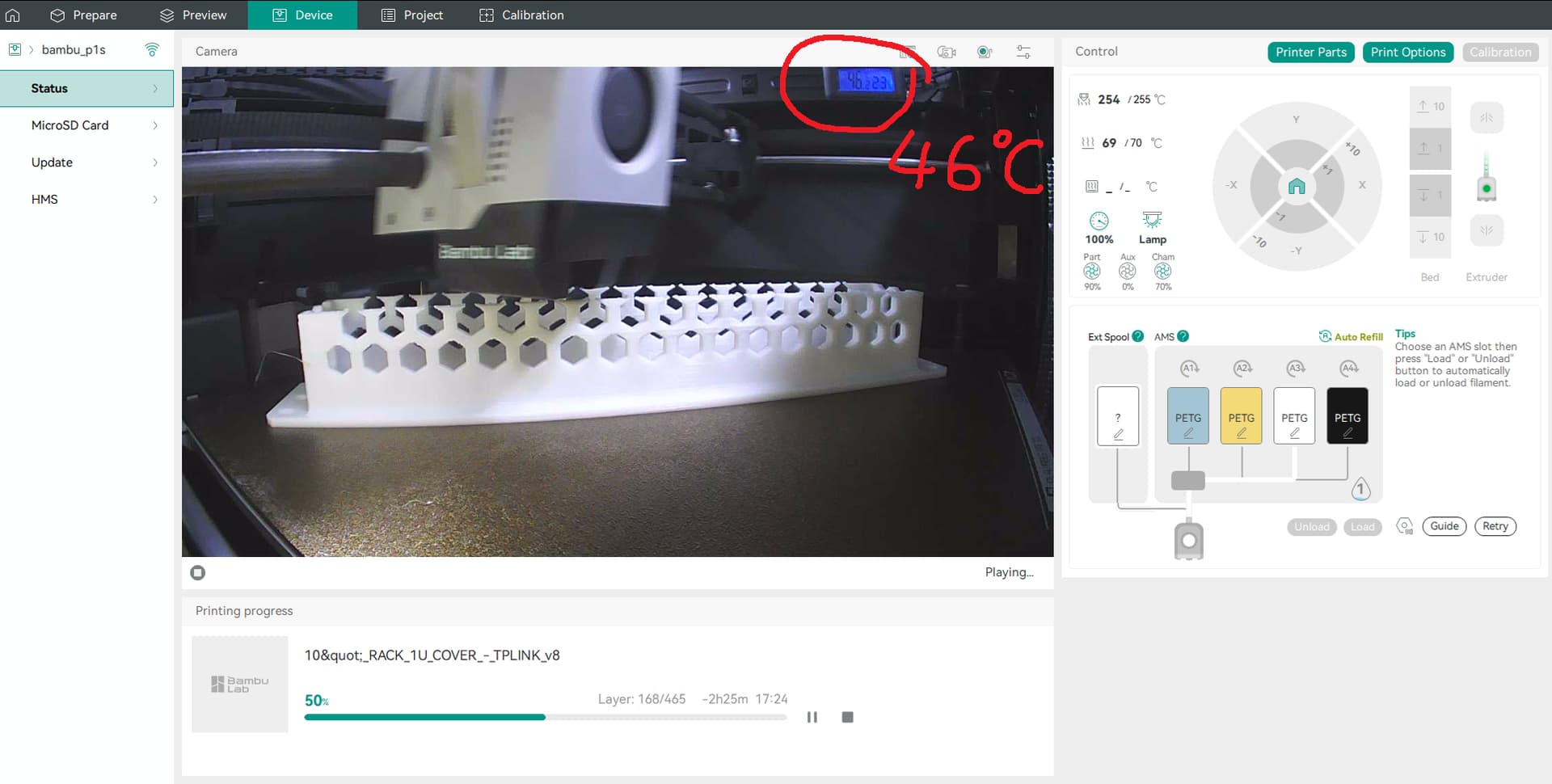

My current print right now: Room temperature 26°C, chamber temperature 46°C
Also slow down print speed quite a bit, but the result is very good layer to layer adhesion
