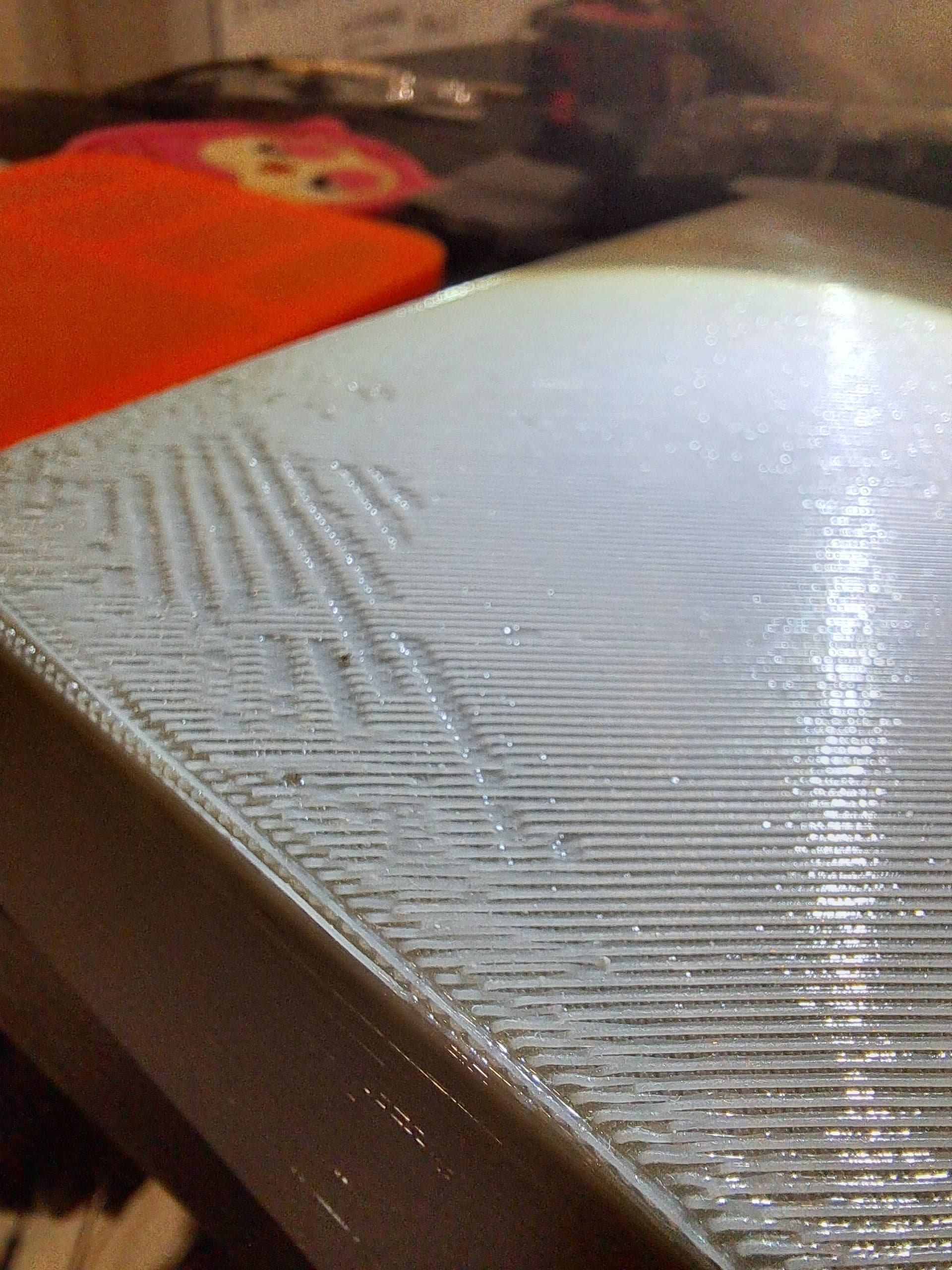

Can you take macro pictures of the bottom surface of your parts?
The one flew off and the one stayed, as detail as possible.
Like this
