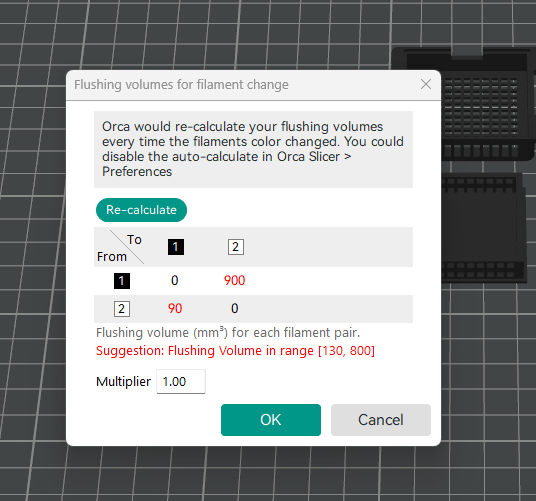

From your 3mf
Put em both to 900 and try again. You likely still have PLA in the nozzle when you only purge 90mm3 of it and switch to petg. You want to purge material type changes extremely well, and not just look at coloring.
