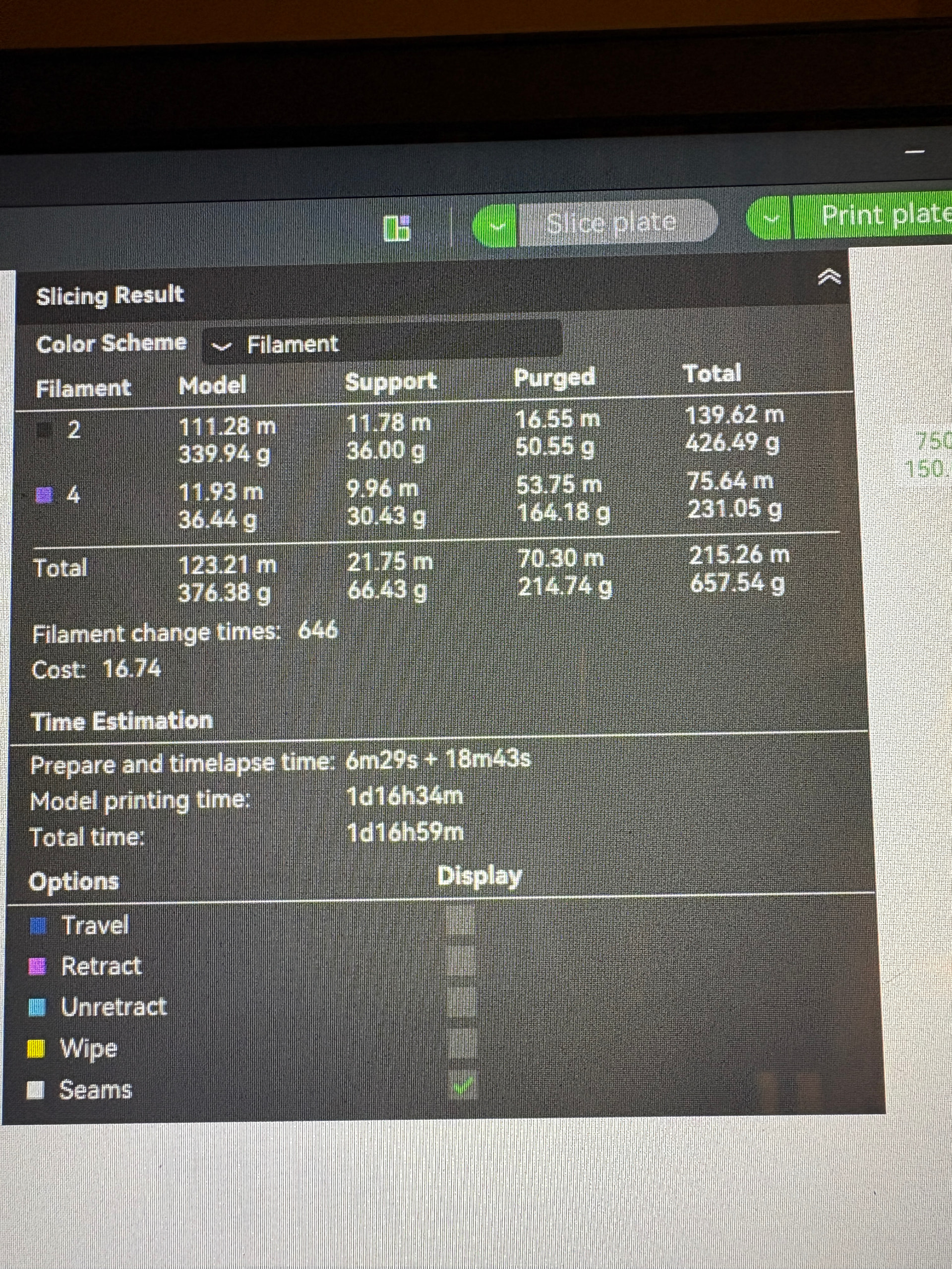

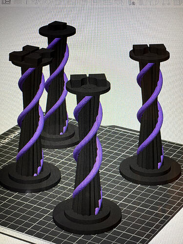

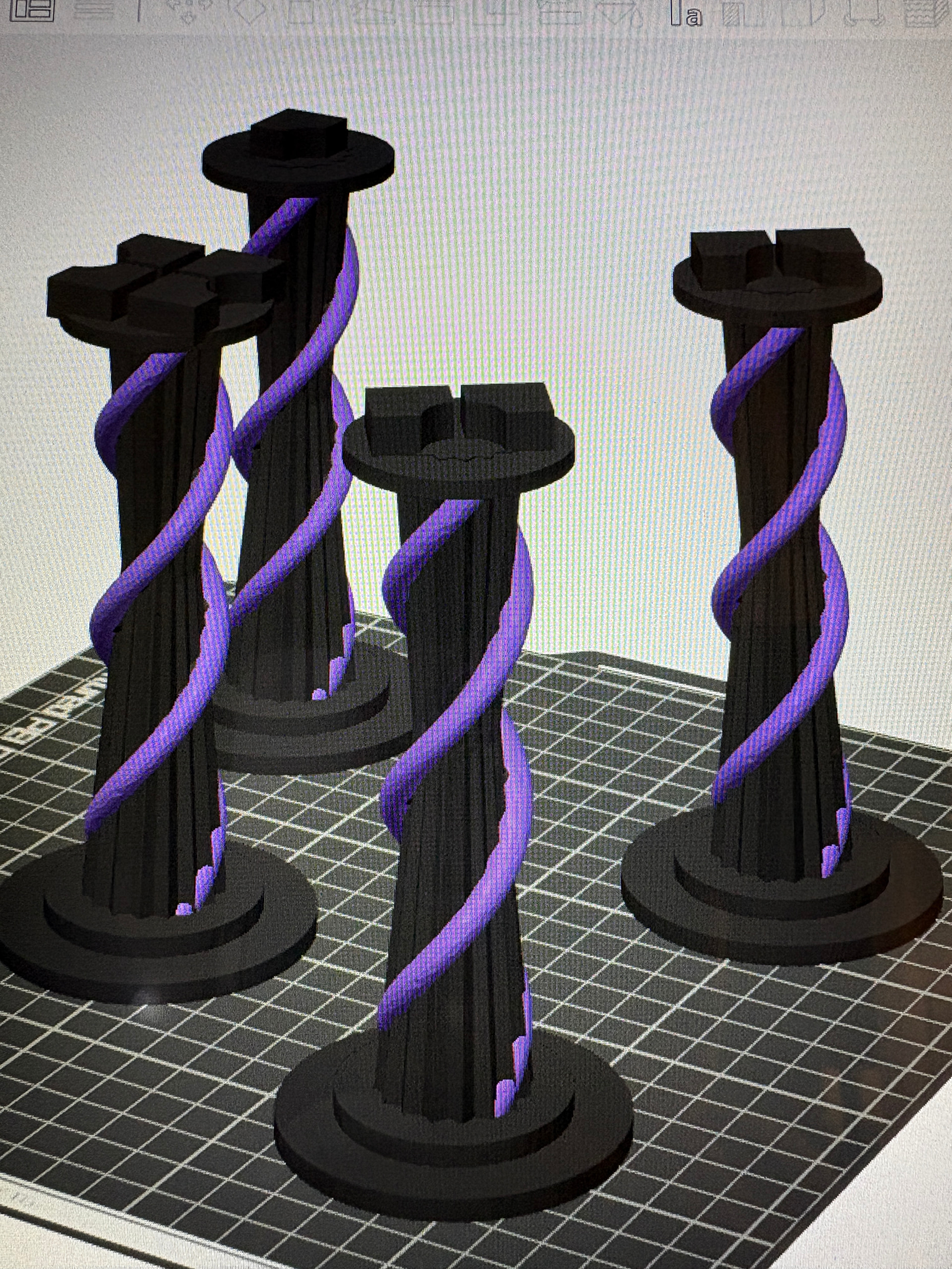

Hi everyone!!! Okay so I have done a few long-ish print like 12-15 hour prints but I’m about to do a 30ish hour print and I’m super nervous and wanted to reach out for any advice or maybe a better way to do this print??? It’s for my Saltwater coral tank and might be one of the items I sell but again I’m nervous… these are 6 inches tall with an 85% infill (can’t be lower than that or it’ll float) and I just wanted a little design flare so I added a helix :dna: from tinkercad in the middle and painted the center brackets so they’re the same color as the tower (not sure if that’s the right move or not). I have the A1 and I have it printing with the stock .20mm settings… I’m not sure if maybe the layers should be smaller due to the details or anything I’m still only a month or two into my 3d printing journey.
Seems legit, good luck! Multiple colors on every layer makes it spend a lot of time purging and changing, but I bet this’ll look good IRL.

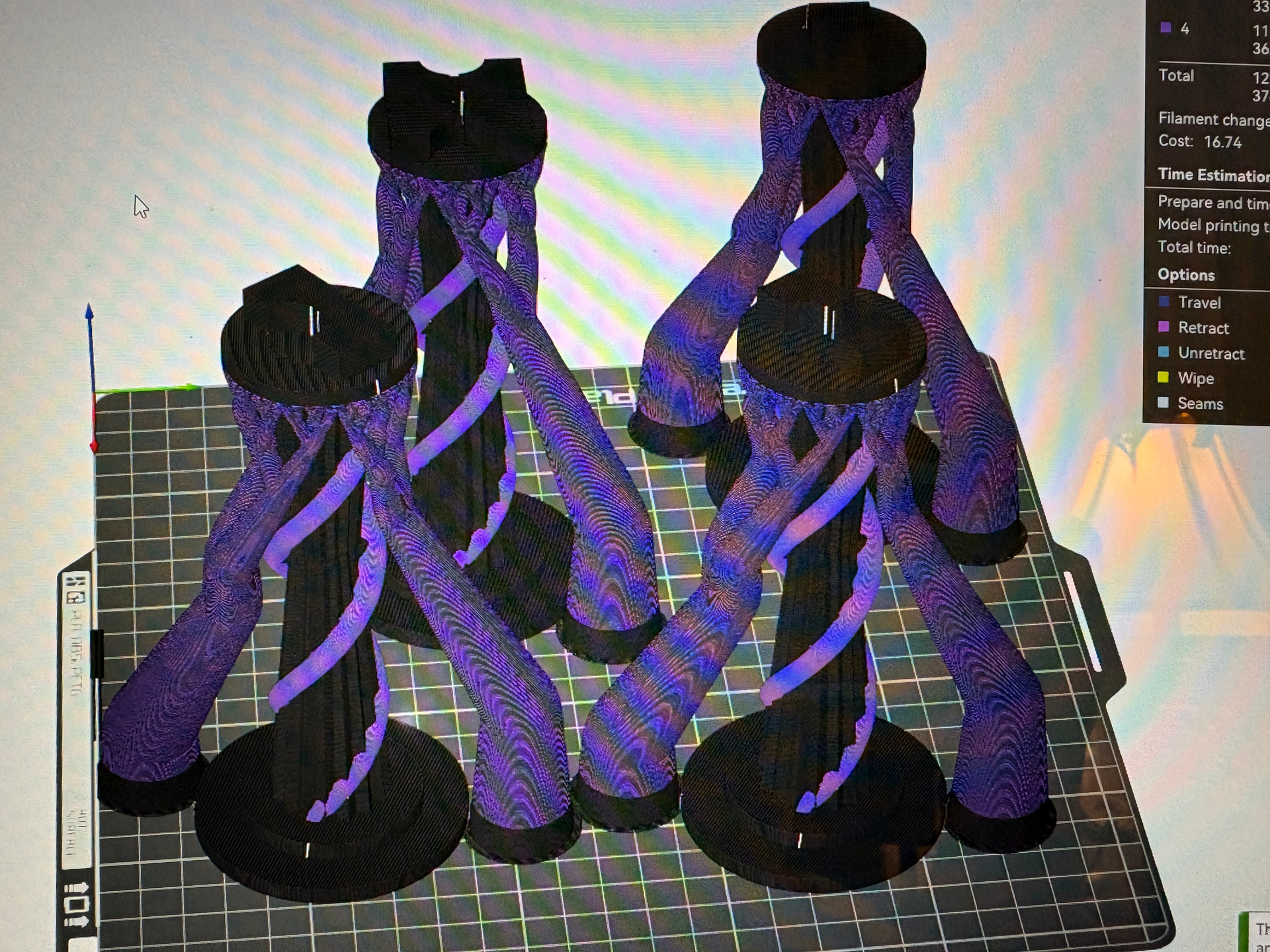

If you dont have a good low acceleration profile, you might consider running it on silent mode [-50% speeds] so the tops dont wobble from the plate shaking. On that same wobble topic, “first layer expansion” of the support will give those supports wider brims too to hold on.

Smartass comment: 1 day 16 hours is 40 hours, not 30.
Hit it and go. 95 percent chance everything turns out just fine. I do not see anything that strikes me as a problem in the preview.

But you also increase the number of filament changes by 4.
because if you printed one at a time, to get 4 of them, you’d purge almost an entire kilo. and spend about 3x the time.

Since, as we all know, the A1 doesn’t have a housing, windows and doors are your enemy. At least when it’s significantly colder outside than inside.
I also notice that the pillars are distributed fairly evenly. Try moving them a little toward the center. The print bed maintains the temperature better in the center. Also, I would try to align it with the toolhead axis rather than the printer plate axis, due to movement and vibrations. So, from left to right.
As far as possible, of course, that won’t work in a straight line - but at least align the pillars a little.

A few thoughts come to mind:
  • The helix leads to a small unsupported overhang at almost every layer. You may want to give that a test print first. It may be desireable to have it supported.
  • It depends very much on your material selection. With PLA, I would not worry too much. With PETG, I’d expect a learning curve (risk of curling, tree detachment).
  • Set 2 walls for the support trees. They are pretty high before reaching the model.
  • Consider a dissimilar material for the support interface.
