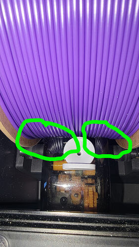

I have a problem with ABS Overture spools and the AMS2. It has nothing to do with the carboard. The spools are too narrow which the filament on a new spool to be too big in diameter. The filament rubs against the feeder unit. I can get it to feed but if it needs to retract…no joy until it has used a bunch of filament. Why ABS? It’s less dense than PLA so 1KG is actually more filament.
Not a problem for AMS HT
