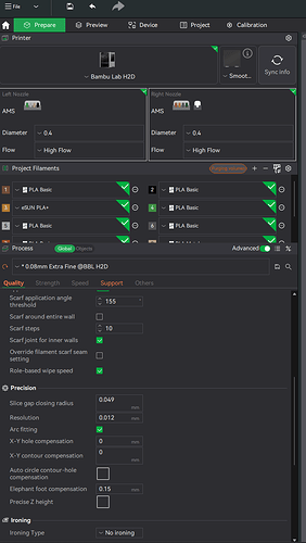

Hello,
I finished coloring my model and when I sliced it, the face was ruined.
The earings are gone, the teeth are broken apart and the nose ring as well.
How can I fix this or if I print it any way it will print correctly?
I just don’t want to start a print that will take 6 days to finish and end up useless.
Any input is appreciated!

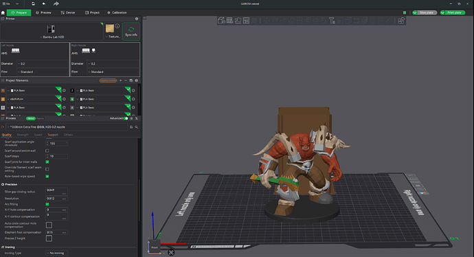

Seems like you’re a WoW gamer as well hahaha. I actually want it at that size, don’t want to make it any larger. You think increasing X-Y Contour compensation will help?
It’s X= 140mm Y= 118mm Z= 125mm
With a 0.2 nozzle it sliced fine, I just did it to check, yet I don’t have a 0.2 nozzle.

So the actual details are rather small.
Can you show the changes you have done on the “quality” tab?
Didn’t change anything except the Seam position to the back. All other settings are default Bambu 0.08mm

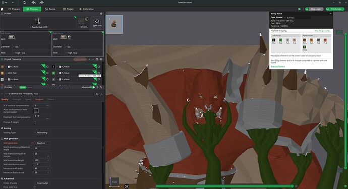

I might be missing it, but what features are gone?
For this size, and using the 0.4 mm nozzle, you can try a 0.16 mm layer height and to enable Arachne under Quality → Wall Generator
It should improve the details you get.
It’s also worth keeping in mind that for your setup, it’s best to try and keep layer height to 0.16 mm as a minimum, to minimize waste filament and avoid increasing print time.
Ok, So with fine details and 0.4 mm nozzle you are limited but I would try:
Either “Detect thin wall”
or change wall generator from “Classic” to “Arachne” (you can fine-tune a lot settings there after enabling Arachne)
Play with the compensation abit yes. And yes i forgot arache cause i have it enabled by default :slight_smile:
I tried detect thin walls earlier but it made it worse for some reason. I’ll give arachne a go now since you all mentioned it.
This is with arachne, way better than classic but still not good enough. Any suggestions on the digits I need to dial in? Also too many seam lines with arachne hmmm.

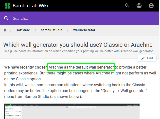

@SupportAssistant, that reminds me of
Which wall generator you should use? Classic or Arachne | Bambu Lab Wiki
(You might want to update the Wiki as “Classic” is default in Bambu Studio, at least for my H2D profile)
