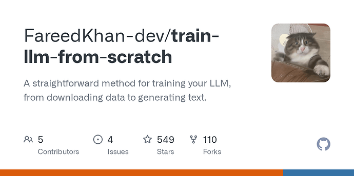

Here is a very detailed guide on how to build your own LLM step by step: But be careful - don’t fall off your chair just yet! This is intended as a reference guide, not something to overwhelm you immediately. You don’t have to follow every step right now; just keep this in mind for later.
But we do it easier! - (at least for now; the other options are still valid)

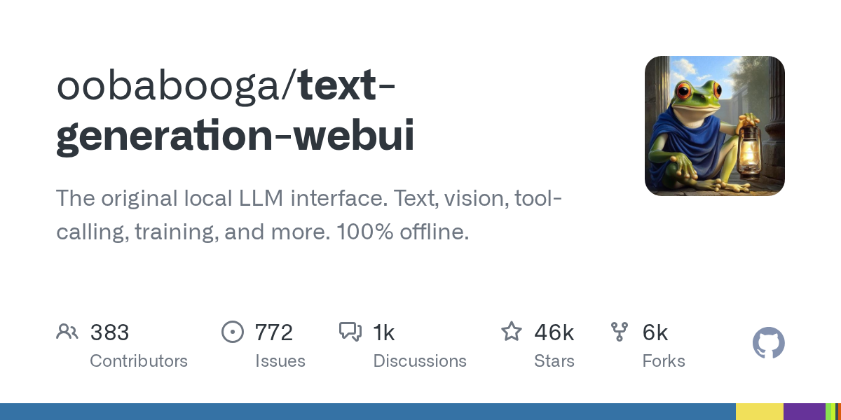

  • Text-Generation-WebUI (Windows installer + training tab)
Easy setup: Portable builds (zero setup, just unzip and run) for GGUF models on Windows/Linux/macOS, or a one-click installer for the full feature set.
  • Download text‑generation‑webui. Go to the official GitHub page for ā€œtext-generation-webuiā€. Download the windows zip release. Extract it to a folder. Inside the folder, run: install.bat. This installs python packages and prepares the environment.
  • Start the webui. Run: start_windows.bat - A browser window will open.
  • Download a model in the webui, open the ā€œmodelā€ tab. Click ā€œdownload modelā€. Choose a model that supports training, for example: llama-3-8b
  • Load the model. Select the model in the dropdown. Click ā€œloadā€. The model will load into your gpu memory.
  • Prepare your training data. Create a file named: train.jsonl Save the file in: text-generation-webui/training/datasets/
  • Open the training tab. In the webui, click the ā€œtrainingā€ tab. Choose ā€œqloraā€ as the training method. This is the easiest and uses the least vram. Select your dataset. In the dataset dropdown, choose your train.jsonl file. If it does not appear, click ā€œrefreshā€.
  • Set basic training options. Use these simple values:
    epochs: 2
    batch size: 1
    learning rate: 2e-4
    sequence length: 2048
  • Start training. Click ā€œstart trainingā€. The console will show progress. Training may take minutes or hours depending on dataset size.
  • Training output. When training finishes, a lora file is created in: text-generation-webui/training/loras/ - It will have a name like: mistral-7b-instruct-lora-epoch2
  • Load your trained model. Go to the ā€œmodelā€ tab. Load your base model again. Then go to the ā€œloraā€ tab. Select your new lora file. Click ā€œapply loraā€.
  • Test your trained model. Go to the ā€œchatā€ tab. Ask the model something related to your training data. It should respond using the style or knowledge you trained it on.

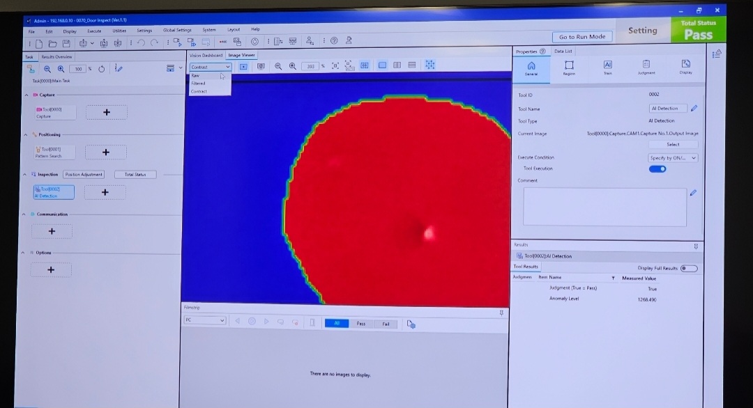

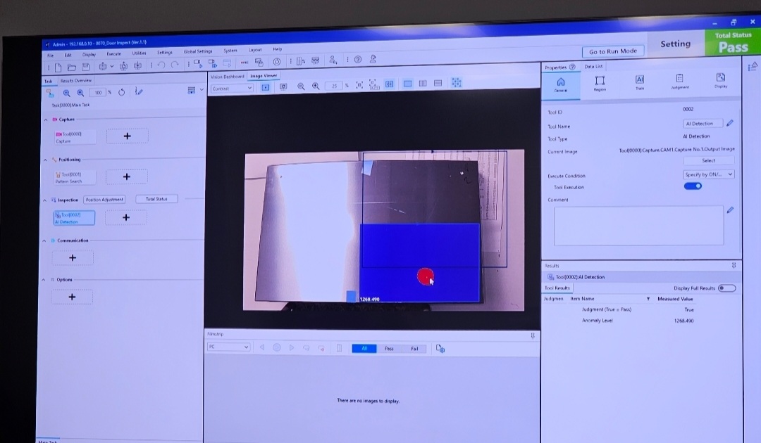

When we talk about AI, almost everyone is referring to LLMs. Machine vision was one of the first applications.
This is from a project that I worked on last year. We were using AI enabled Machine vision to check for denting, discoloration, blemishes, etc on some larhe appliances. Reasonably, the pass fail metrics for this system took roughly 80 hours to get fully programed but it has worked flawlessly.
I love it because it makes determinations, flags and logs the unit, bypasses it to a wip area, and logs common areas of damage. It cost a few hundred grand, but was capable enough to replace 4 operators per shift over 3 shifts (with triple the reliability when you consider half the people on 3rd shift are high).
