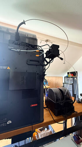

The various community-designed mounting solutions for these tools typically place the switch on the left side and the feeder on the right side (when viewed from the rear). However, this arrangement makes it impossible for me to feed TPU from an AMS HT unit, as the AMS is positioned on the left side, while the access point for the feeder is on the right.
It would be great if Bambu Lab could develop a design where these tools are arranged in a way that meets the necessary specifications, yet allows for the filament to be fed from the right side (the feeder side) via AMS HT.
I am not sure if any of the currently published third-party mods would work for this purpose.
My actual build doesn’t look perfect to me.
Thanks.

As you see in the picture I use the AMS HT with the side feed to dry the TPU during printing. It works perfect! Other Maker use this configuration on top without feeder: AMS HT, side feed direct to printer head from the top.

The first: same input side,
nothing else, I want to use both tools separate, want to mount them standard on the backside.
My version on the first picture works that way, but the switch is mounted upside down, the feeder couldn’t be handled perfect and a belt revision hole is blocked. So my hope is, that bambu can create a better version to use.

I use this mount right now, because all needs for both tools are supported and the input is on the same side.
When there is no better design or Bambu wouldn’t support that need, fine. Just want to now.
