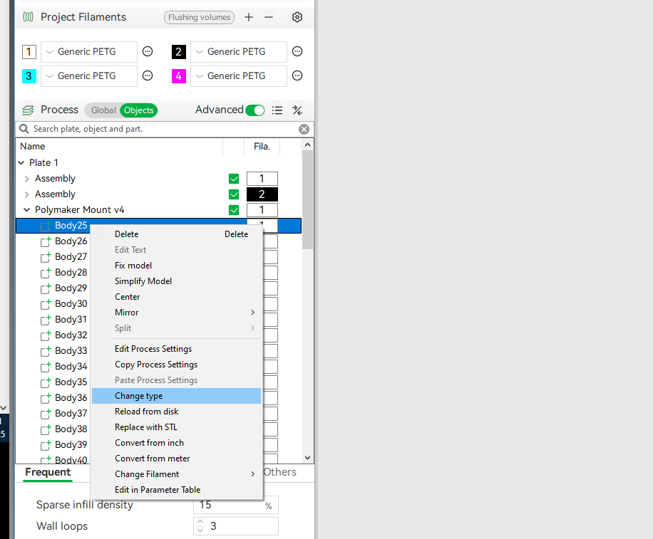

Currently (2.1.1.x); I can can select multiple bodies or Assembly sub-bodies and change things like Filament Spool, infill, etc…
But frustratingly, I can’t multi-select Assembly sub-bodies and then use “Change Type”. I have to do each sub-body step by step through the pop-up dialog, over and over.
Most assemblies I import are 1 part and 40-60 Part modifiers. I have to manually 1-by-1 change all of them from “Part” to “Modifier”. Then inevitability, I must alter the part in CAD, and re-import, I have to do the “Change Type” all over again… 1 by 1… its monotonous…
And then when my print bed has 7 Parts that are all assemblies… you get the idea.
1-by-1
Multi-select doesn’t work
So I had previously been making all the Modifiers directly in Bambu Studio, but The issue is that Aligning them takes even more time… and every change/tweak they need to be all redone and re-positioned.
So I’ve go to adding the Modifiers directly in CAD, so every time I make a change, the modifiers come along too and are already in the right place. I just need to mark them each as “Modifier” than then I can multi-select all of them to change the properties.
So Multi-select “Change Type” for objects in a assembly would be a great frustration and time saver.
