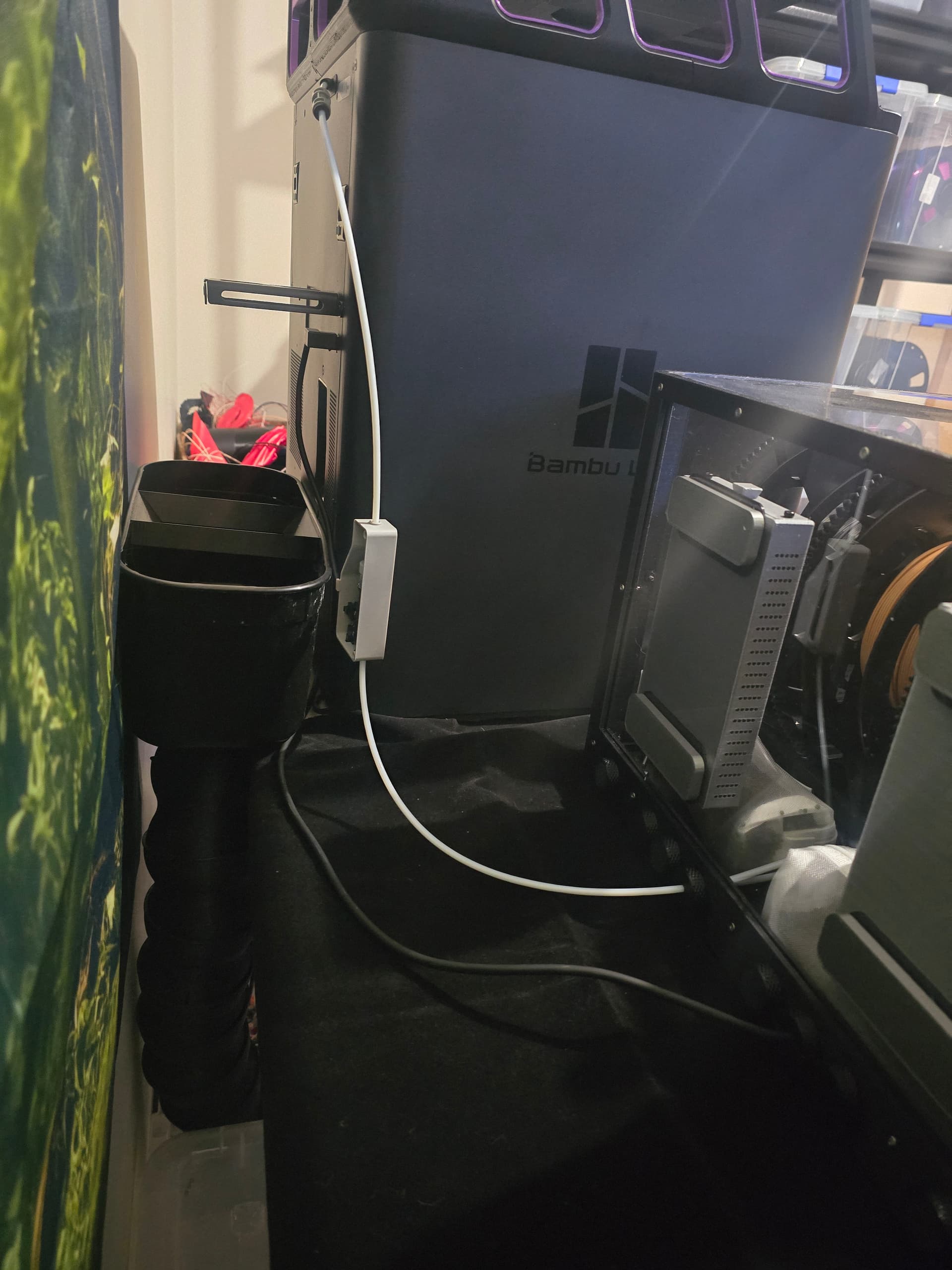

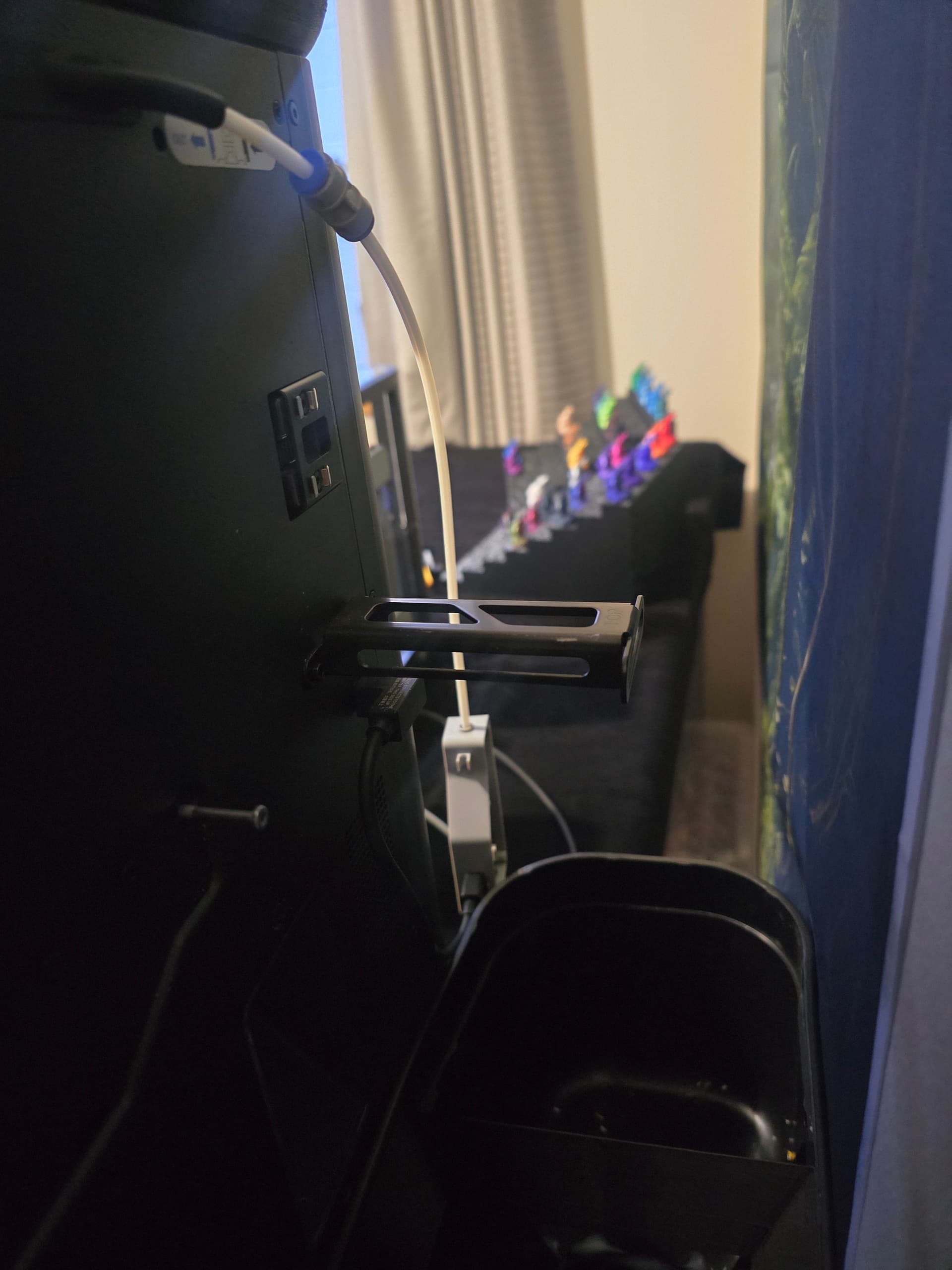

Pictures of your PTFE tube routing please?

I had one issue with the X1C and AMS, the PTFE coming out of the AMS had too sharp a bend that caused binding. Resulted in intermittent failures. Realigning the tube so it didn’t have as much of a bend fixed that.

As you can see, I even removed the buffer off the back and shortened the tubes to try and reduce resistance.

Nothing wrong with the filament path, but there could be plenty of things wrong resulting from the modifications. If you’re serious about troubleshooting this, you need to put the AMS back together the way it was when you first got it and then see if you still have a problem you can maybe blame on Bambu… provided you haven’t reassembled it incorrectly or broken something in the process.

Your issue though sounds like PTFE and coupling related, and specifically your rewind issue sounds related to your PTFE shortening modifications. These machines are dumb - they know sensor fulfilled, sensor not fulfilled, and preprogrammed actions to get them between those.
Watch the filament’s leading end, whatever fitting it “stops in” and retracts to retry - cut the last 1mm off that ptfe tube using a square cut tool, and really freaking ram that baby home into the pneumatic fitting. If it’s an actual fitting and not the actual toolhead, replace that actual fitting. If it’s on the toolhead, observe if the final bend is too sharp. Stock glass with no riser is OFTEN too sharp.

I have tried the AMS on top, behind, to the right.
My first upgrade was the riser with drawers to take some stress off the tube that feeds into the extruder. Then I went into the little clip on parts with ptfe tube that you click onto the top of each feeder motor. It was a gradual series of 1 fix at a time to try and fix issues. The python upgrade was due to being so frustrated with the constant empty or full spools causing issues and the tangles. It has eliminated the spool issues.
