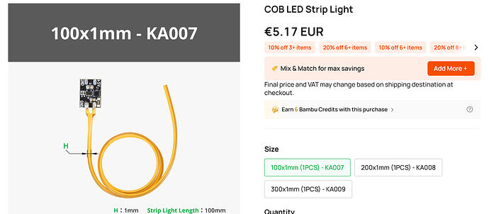

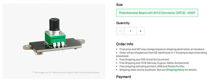

Another model I have uses a USB power cord with PH2.0 connector connected to the 100mm Y Type PH2.0 to Dual SH1.0 Conversion Wire, with one SH1.0 “Y” plugged to a potentiometer (set dimming even when the power is cycled), and a COB LED light strip on the other SH1.0 “Y”. I would like to have something similar connected to the lithophane backboard, allowing remote on and off to a set dimming level. Unfortunately, the solution above ends in a SH1.0 plug, not a PH2.0.

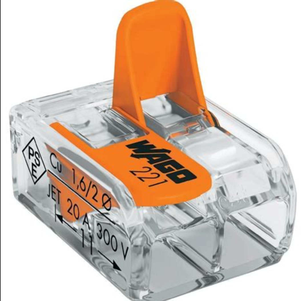

Cut the cable in the middle and use clips like these - I did the same thing with my LED setup because it’s convenient. I think you’re overcomplicating things.

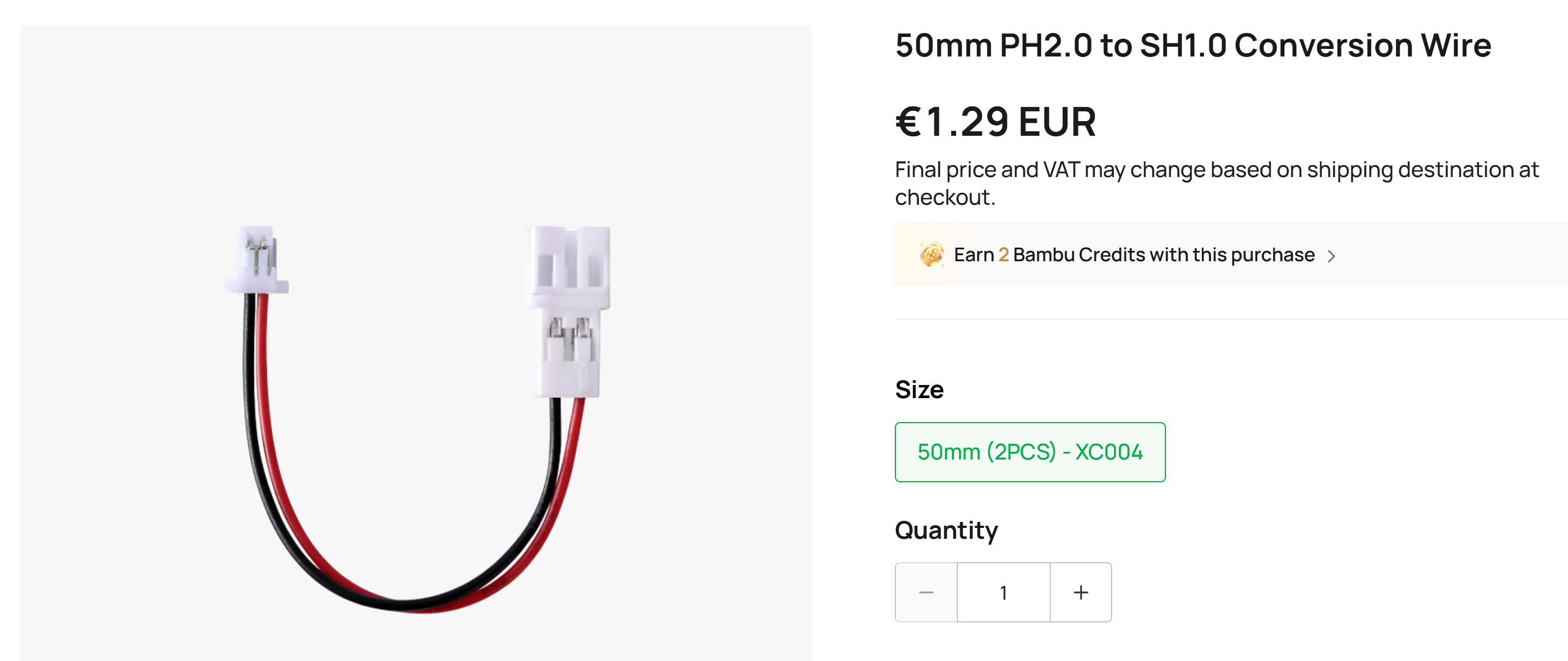

…or you can buy an adapter cable: “SH1.0 plug to PH2.0.” Bambu even offers one. There are other options as well, depending on what you need. Whether as a male (plug) or female version.
https://eu.store.bambulab.com/products/50mm-ph2-0-to-sh1-0-conversion-wire
Without even looking up the specs of the backlight or pot, that seems like potentially an enormous amount of power being dissipated in the pot which it is almost certainly not rated for. Is this configuration something makerworld recommends?
Yes, recommended and also sold by Bambu:
However, it is not suitable for his other set; it is only compatible with Cob LEDs. It is not compatible with the Lithophane LED Backlight Board Kit. This is not due to the plugs, but rather the wattage – I have just checked. He’ll need a kit that can handle 10 watts.
