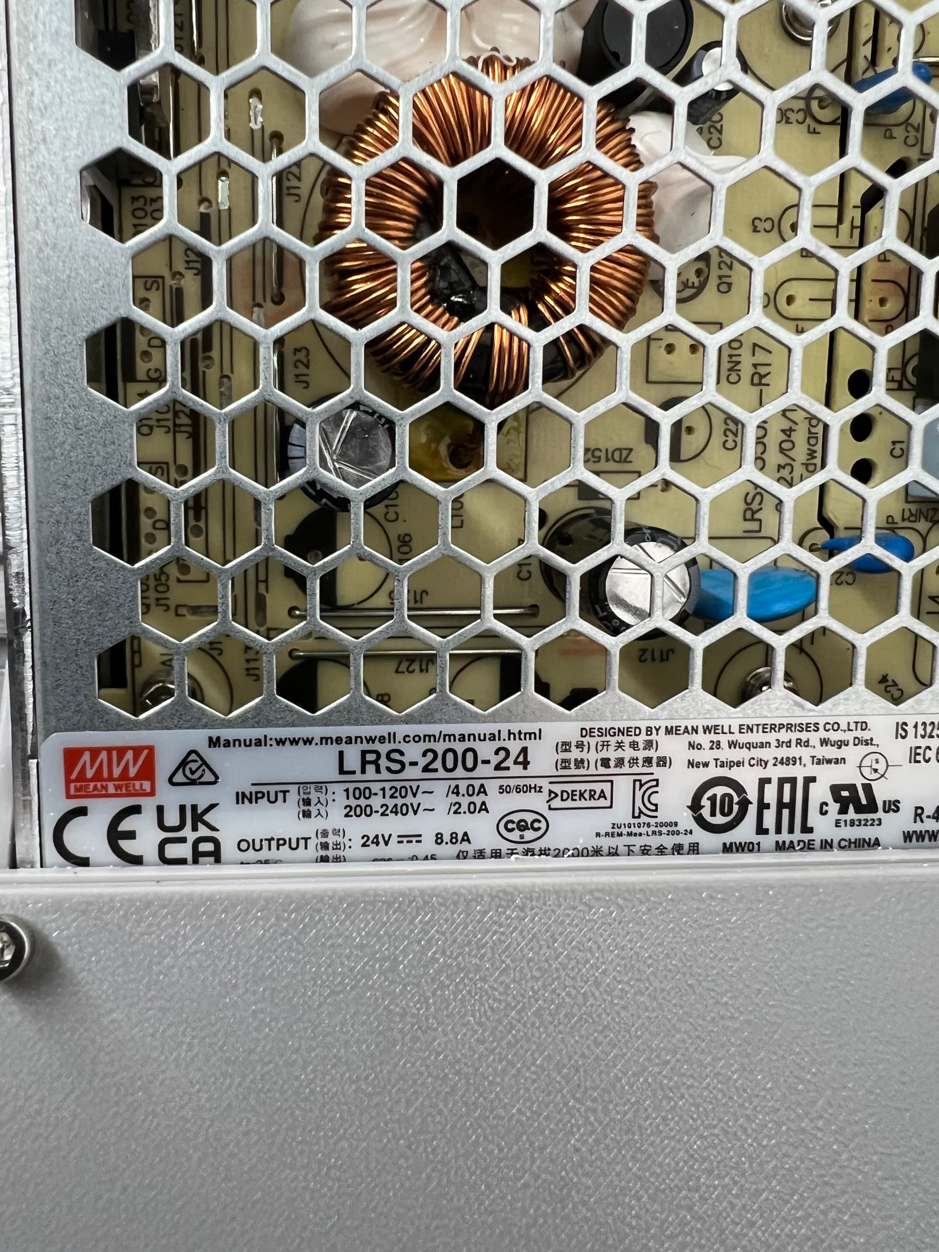

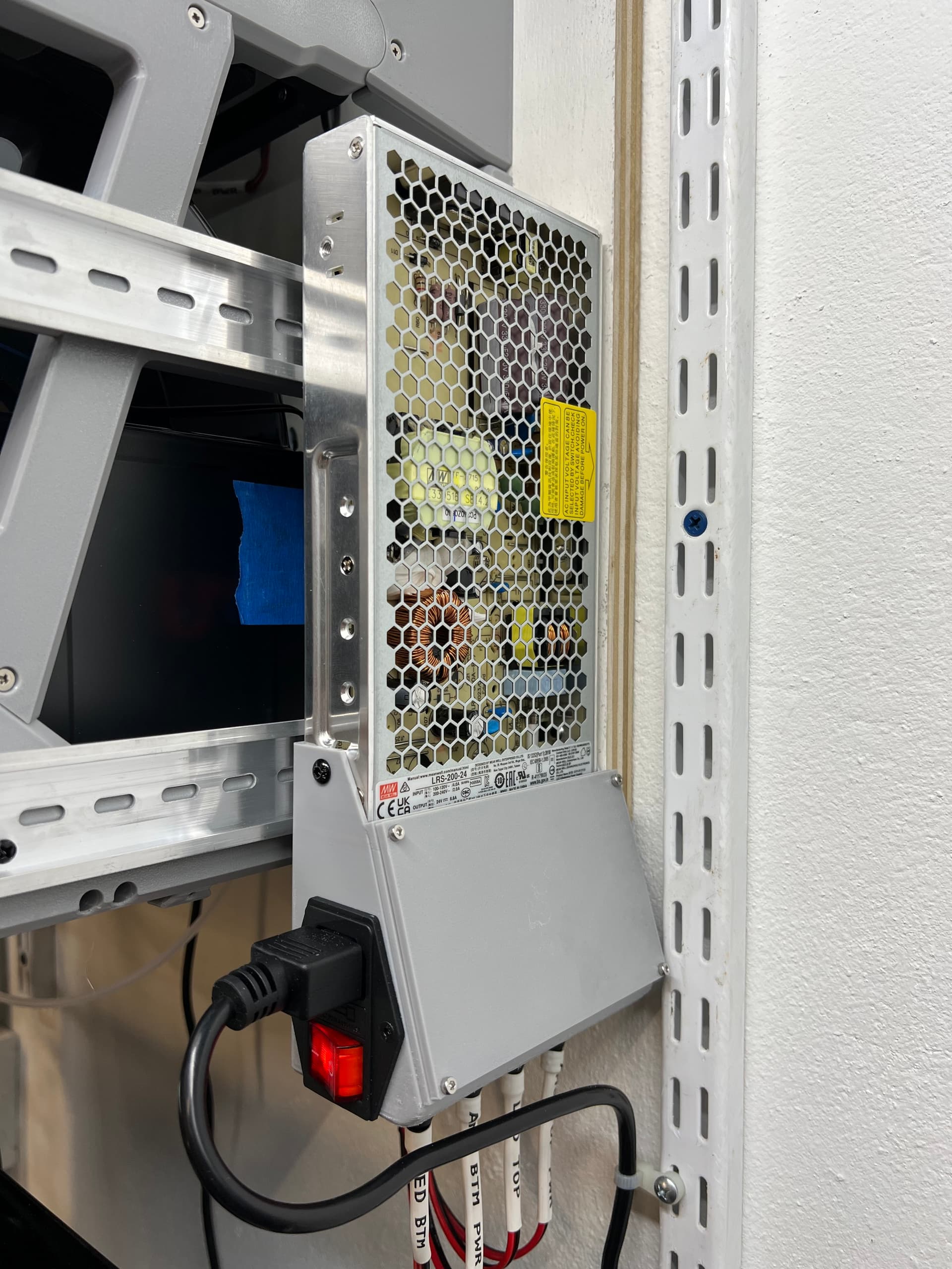

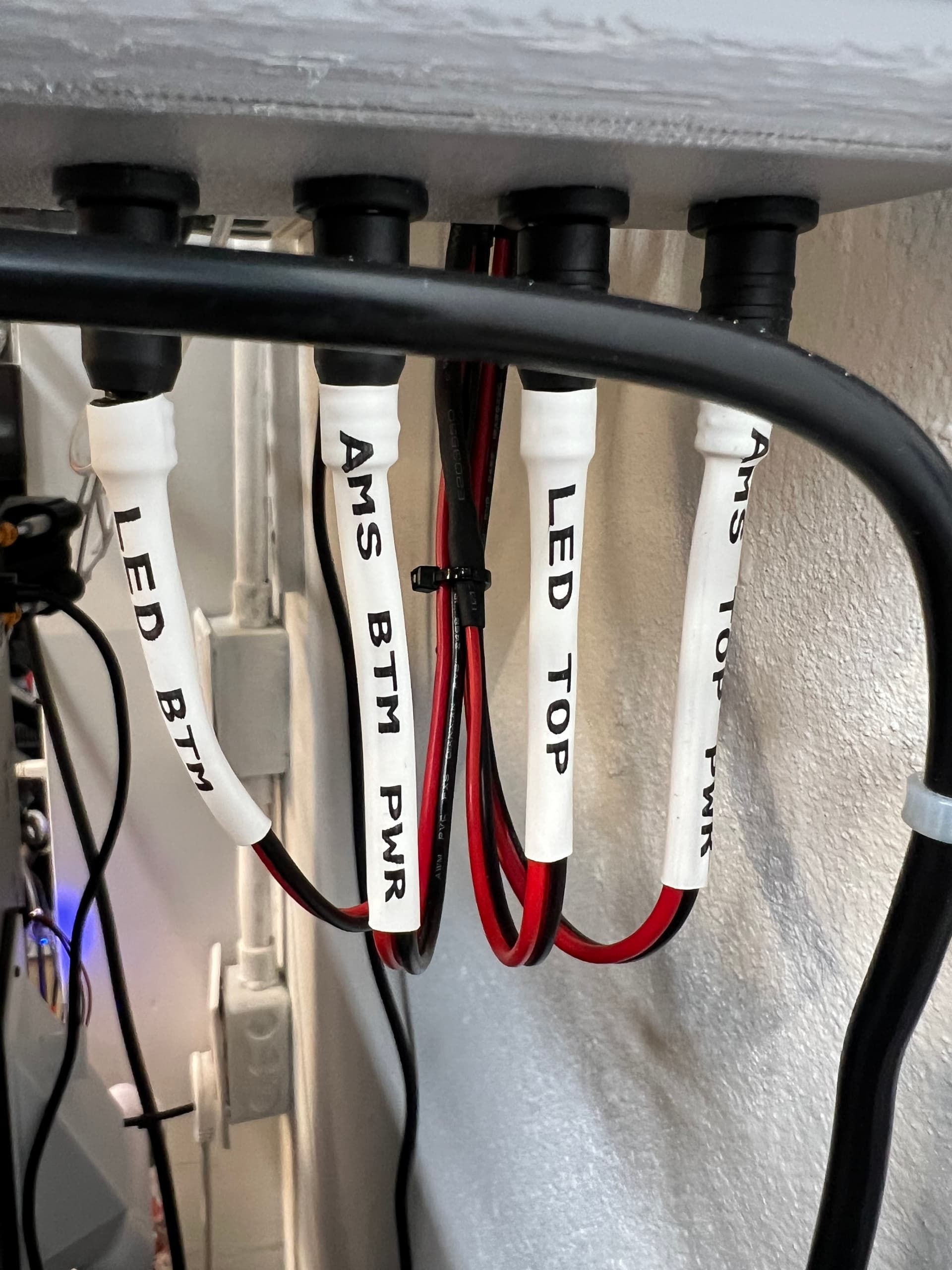

Does anyone have a recommendation for a cheaper power supply than the ones from Bambu?
Maybe not cheaper, but a power supply I had on hand.
This power supply works with the AMS 2 Pro - plus Amazon Haul has a deal on where you can save £10 on orders over £20:
What are the specs, so I can find it in the US? Thanks!
Is this correct?
The AMS 2 consumes no more than 2.75A (66W) in drying mode, so the 96W power supply will operate for a very long time without overloading or overheating. (They could have made the heater more powerful. It takes 45 minutes to heat up to 65 degrees.)
