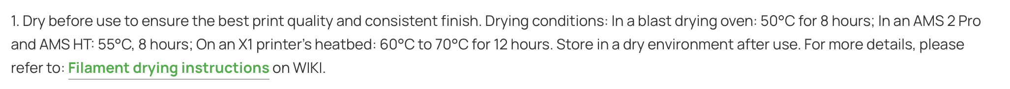

For PLA basic, the oven recommendation is 50C for 8 hours. The AMS 2 Pro and HT recommendation is 55C for 8 hours.
50C vs 55C for 8 hours is hardly a significant difference. I was just curious if there was reason for the AMS 2 default PLA change to 45C for 12 hours.
They changed it after people complained they couldn’t start drying when they still had some PLA spools loaded into the feeder slots (would become too soft at 55°C).
