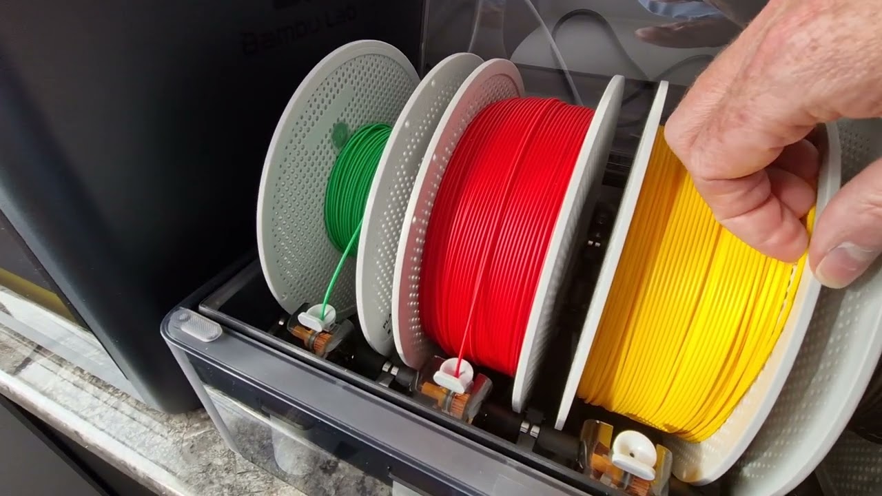

I joined just to say this post from Ares0559 fixed my brand new AMS2 Pro. It worked for 2 prints and no heating cycles before it failed.
I removed the board from the motor, removed the two magnetic sensors, bent the legs and soldered them back into place with very close clearance to the magnet and I’ve been able to feed filament from the AMS for a print first go.

TLDR: I believe the issues many of us are facing are partly with the AMS 2 units but also the AMS Hub (the one that attaches to the back of the printer).
At least in my case, switching to AMS units of the old version has improved things a lot, but the issues still crop up sometimes due to the AMS Hubs I have (now waiting on replacements for the hubs)
I had 2 AMS 2 units that were showing the issue of multiple loading/unloading cycles and often the outright issue that the filament wouldn’t feed completely and I would have to hit “continue” or “retry” to hopefully continue the print.
Support sent replacements for the boards of both AMS 2 units but in the time they took to arrive, one AMS 2 unit developed another issue where Slot 1 would not turn the spool at all anymore. Sent them video of this and told them that I refused to even attempt the board swaps given that there are other issues cropping up as well and I demanded a refund.
While awaiting the response I couldn’t wait anymore, work is piling up not being able to print reliably, so I got 3 other AMS units of the old version.
They agreed to the refund (I’d imagine because there was more than one issue now) but because one of my AMS 2 units was a bundle with a P1S printer, I would have to return the printer as well. I need the printer so we settled on one AMS 2 unit refund and one replacement. Not exactly hopeful about the replacement, though.
Meanwhile, the old-version AMS units arrived and I set them up. Working fairly well, but soon, same issue. After a lot of testing it was obvious that the issue was much less frequent, but still present.
I then tested each unit individually through an AMS Buffer and 2 different AMS Hubs (bought at the same time as the AMS 2 units) each going through multiple prints with 40 filament changes each. The results?
AMS Buffer = Not a single issue for any AMS (old version) unit
AMS Hub = Each print had the issue at least twice
When first troubleshooting the AMS 2 units I also tested them with AMS Buffers and the issue was still there which is why I though the problem was exclusively with the AMS 2 units.
With these other results, however, it’s fairly clear to me now that at least my problems were not just the AMS 2 units but also the AMS Hubs as well.
For the time being switching to old -version AMS units has allowed me to print semi-reliably and I am currently awaiting replacements for the 2 AMS Hubs which hopefully will resolve the rest of the issues.
For clarification, im using a single ams 2 pro with a buffer, not hub on the back of my p1s
Yeah I believe that set up will show issues. When I first was troubleshooting my AMS 2 units I tested them with a Buffer and still had issues. There is clearly something wrong with the AMS 2 units.
But there is also something going on with AMS Hubs. Both together (what I had) just compounds the problem greatly.

One thing I have just noticed is that if I hold the PTF tube going into the extruder as the filament is loading, its fine. Just confirmed it on 3 different filament swaps that were having issues. I can’t stand there during a 4hr print doing that though! Maybe I’ll try replacing the PTF tubing. Not sure what else to try…
I’ve been doing some extensive testing and I think that I’ve narrowed down my issue to the AMS external hub for the AMS’s. When either AMS 2 is connected to the hub, I would consistently get these errors on either AMS 2 and/or single or multiprint jobs. Over the weekend, I removed the AMS hub and went back to the single AMS 2 buffer. Have done 5 different multi-print jobs and both AMS 2’s with no issues. Will be plugging back in the AMS Hub again after more testing to prove the theory (at least for my case).
