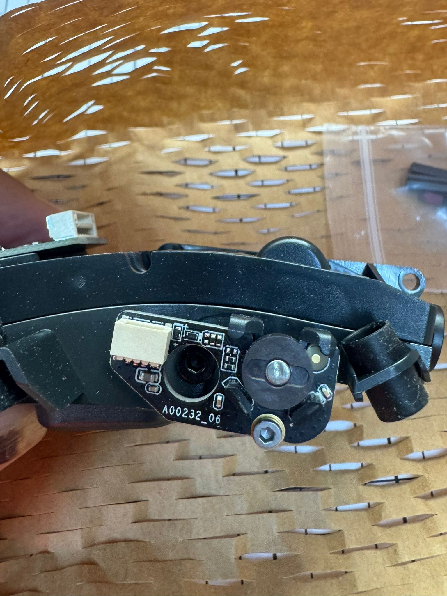

They sent me a new AMS 2 Hub which I installed today, and after numerous prints with numerous loads/unloads, it’s currently running fine. Hopefully it stays this way.
Esa es la clave, he acercado los sensores y ya funciona mi AMS2. Gracias por la solución, espero que el Soporte de Bambulab encuentre la solución y mande esa plaquita que no debe costar mucho y se cambia fácil.
Got my replacement hub fitted and so far things have been fine running on my H2D. I think this proves that the issue is definitly down to the hall sensor for the hub motor, when replacing the hub the motor is used from the previous hub and is working fine so it must be the sensor that is at fault.
I image that Bambu are fully aware of the issue and we will see a redesign / replacement sensor being used in the near future. I just hope my new hub continues to function without issue, the first one only lasted for just over 400 hours of printing.

On review of the nature of the issue, we believe the issue is related to the odometer within the AMS internal hub having a signal issue.
It may be the case that the issue can be resolved by resetting the connections between the AMS internal hub and the AMS main board. As such, we would initially ask if you could please refer to the following guide and implement the steps detailed: HMS_0700-0200-0002-0002: AMS A The odometer has no signal. The odometer connector may have poor contact. | Bambu Lab Wiki.
If, during this process, any damage is found, could you please provide images of this?
If no damage is found, but after the steps have been completed, we can proceed to arrange for a replacement internal Hub to be shipped to you.

I stripped my AMS2 down twice and removed and remade the hub connections to the main board. On both occasions the first feed out of it worked fine but then it stopped working again.
I am several prints in after completley replacing the hub and it is working as it should do.

Yes it was a replacement from Bambu. I did carefully compare it to the old one when I took it out and couldn’t see any difference with the sensor board but it looks exactly the same.
Me acaba de llegar la pieza que me envía el soporte de Bambu, parece que se han dado por enterados de cual es el fallo, yo ya habia juntado y resoldado los sensores como dijo el compañero Ares0559. parece que vienen igual de separados, para mi gusto deberian estar mas juntos. o sea que no han rediseñado la pieza.
