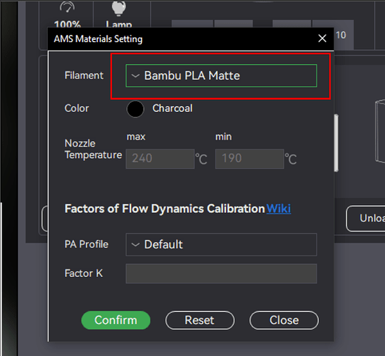

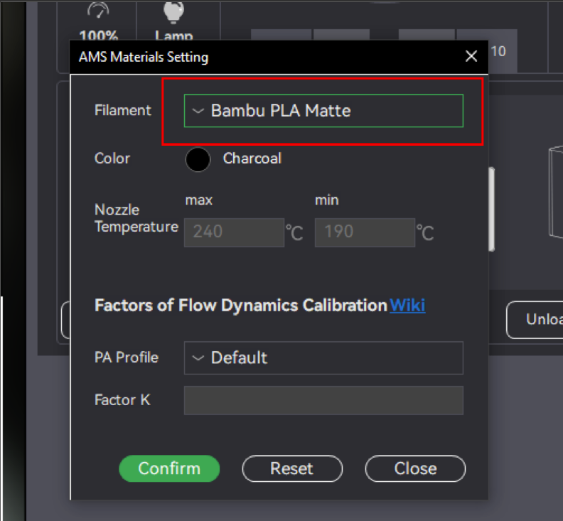

In Bambu studio go to “Device”
click on the pencil of the spool you just inserted
click on this tab ( might say something different for you since i already selected it)
and then select whatever fits your filament

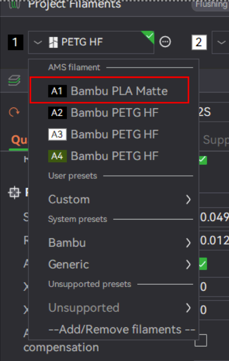

in the prepare tab click on one of the filaments slots (the order of those do NOT correspond to the actual slot of the AMS. So Project Filament can be ABS while the actual Slot 1 of the AMS is PLA. It’s just what filaments you have inside the project.
Select your AMS slot

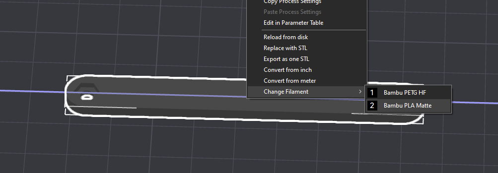

and depending on the project filaments you have you need to select the actual model, right click and switch filament

After 2 1/2 days of frustration I finally sorted out the issue I was having. I created a custom filament profile for PETG but was unable to get Bambu Studio to allow me to print with it. After hours of watching YouTube video’s and reading online articles I finally managed to make it work. On the printer I selected the appropriate slot in the AMS and selected the custom filament profile and still couldn’t get Studio to accept the slot, I re-mapped multiple times with no luck. After reading an article this morning after a Google search I reading something that turned the bulb on in my head. It stated that you had to select the model in Studio, right click and set the filament type for the model. The issue was that the model I downloaded had PLA set at the print filament and Studio and the printer wouldn’t allow me to print until I changed it to PETG. Thanks for all the help from the community.
Which is…what i told you :upside_down_face:
Thanks for pointing that out, I completely missed it when I read your post. So many little details, it’s hard to keep them organized in my pea brain :-).
