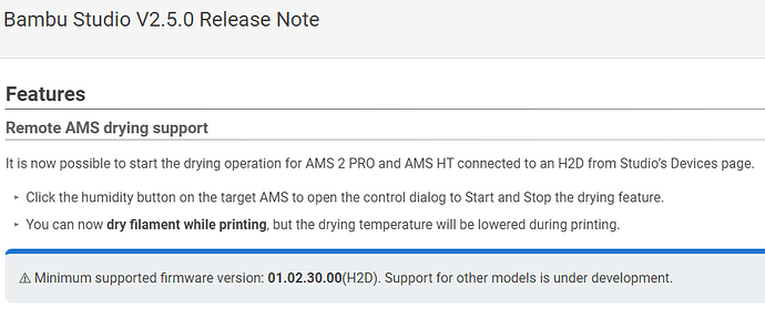

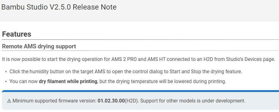

Some progress: Drying while printing and starting drying remotely.
It seems like it’s not for the P2S though - at least I don’t have the option after an update and there is no new Firmwareupdate showing.
Seems to be limited to the H2 as of now.
yeah, I should have gotten an H2C…
It will be available on each printer series. You just have to wait for the firmware.
Like drying with PLA in the AMS with the P1S - which never came for weeks/months until I got the P2S. Yeah…
Drying while printing AND drying via the app are part of the beta program. You have to join the program to get the firmware that activates these two. Its a promising improvement as it does two items that are asked for in this thread. Just waiting on the firmware to upload to give it a try. It is trickle down so starting with H2D, then C/S then the smaller ones that use AMS.
