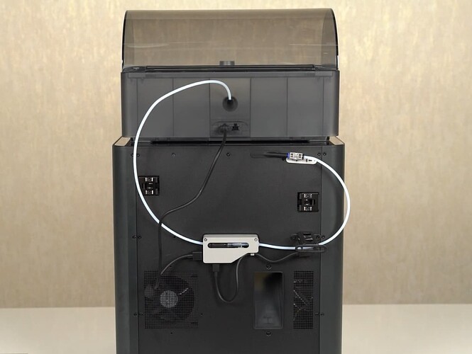

Ive just got my p1s deliverd, and i connected the AMS, it worked, then i moved my printer to my bedroom and since then the AMS is not working. The printers says the AMS is ofline and the four lights are blinking red. i tried everything with the cables. but nothing worked. now i am really bumped about it because i wanted to print realy bad. :frowning: i checked the motherboard of the AMS if the cables were good they are all the way in. I checked the tubes if there was any left over White Fillament there isn’t. it seems the 4 pin cable from the buffer to the printer. on the printer side it looks like it is loose, but still nothing happens when i push the cable in and i hold the cable. can somebody help me please? i dont know what to do, i already put a support ticket out.

Are you able to show some photos of how the AMS is connected to the P1S?
Just wanted to confirm that it looked something like this:
This diagram and wiki helped a lot since I am a more visual troubleshooter.
