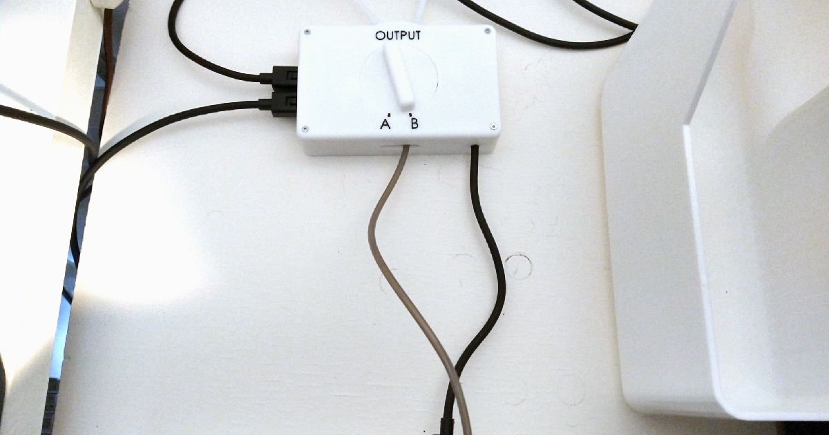

The Bambu has spoiled me. My dream is to attach a filament management system to the XL and Bambu, where I can share a pool of filaments across all my printers. My AMS switch is the first step. I’m working on a modified version of it where the ground signal switches in first and out last, like the connector.

I made a second switch, where I added lobes to the knob so the ground signal engages before the rest of the signals when switching. I also swung the cable to the AMS to the bottom side, so it comes out in the same direction as the PTFE tube for it. I could move the A/B electrical connector to the top side, but it would just make the case wider.
Ideally this should be mounted on the top or side of the AMS, but it would only add more length and bends to the PTFE tubes. I have the space with my current setup, but I would be happier with a cleaner solution.
And here is a picture of the modified knob.

Apparently my switch model violated a Bambu posting rule and they blocked it. So I took it down. I suspect they were worried about incorrect wiring taking out your printer, which is a valid point. But with careful wiring I made two of them and they both worked, however I did triple check the wiring before in plugged them in. Contact me if you are still interested in making one.

I have been using my version of the electrical side of the switcher for a while now which is basically 3 DPDT switches (6 switches).
I notice your design uses 12 switches? Is there a reason for this? My version works perfectly well with 6 and technically I could use 5 as the ground wire can be common.

This post to express gratitude to your design. I purchased a H2D and connected my existing AMS which was on my P1S in addition to a new AMS2 to my H2D to benefit from the dual nozzles of the H2D. I did not want to purchase a new AMS for my P1S and this switch saves it. When I need to use the P1S along with the H2D both running on one nozzle only, I can simply switch the AMS from THe H2D to the P1S.
I modified slightly your design just by extending it 15mm on each side so to have more room for the AMS power board connections and induce less stress on those. I also made some cosmetic changes as you see just to please my taste :slight_smile:
Your instructions were great and clear (it was missing the spring and ball installation btw) and the soldering jig was a great addition! I used ECAS04 PTFE connectors which are cheaper and easier to provide at least here on Amazon EU, only had to enlarge entries to 8mm dia.
BTW I did not cut any traces on the power board, I just unsoldered ALL chips on the board (some transistors, capacitors and resistors) and this totally isolates both connector from each other.
It works really great even on hot swapping, I no longer either have to disconnect and reconnect the AMS or simply use an external spool when I’m lazy.
