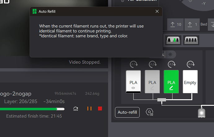

Question about auto refil
I used the option recently with great success slot 4 empty it started on slot one , during printing if you clicked on auto refil it gave a, it will be used message in studio ,
today (currently im hoping to achieve the same outcome slot 4 empties and it continues with slot 1
both black bambu pla, but for some reason they appear to be the wrong way round both in studio and printer as seen in the image ,can anyone throw any light on this ?
or could it be due to this being wrong ? its difficult to see if it highlites one over another when you click on it
Just as a, the generic white in slot 2 is actually half empty and the bambu green in slot 3 is half full
Thought i would update the post
Good news the auto refil adjusted itself after spool 4 became empty
Automatically refreshing itself during the print ( cant be done manually on the h2s ) so all turned out well
