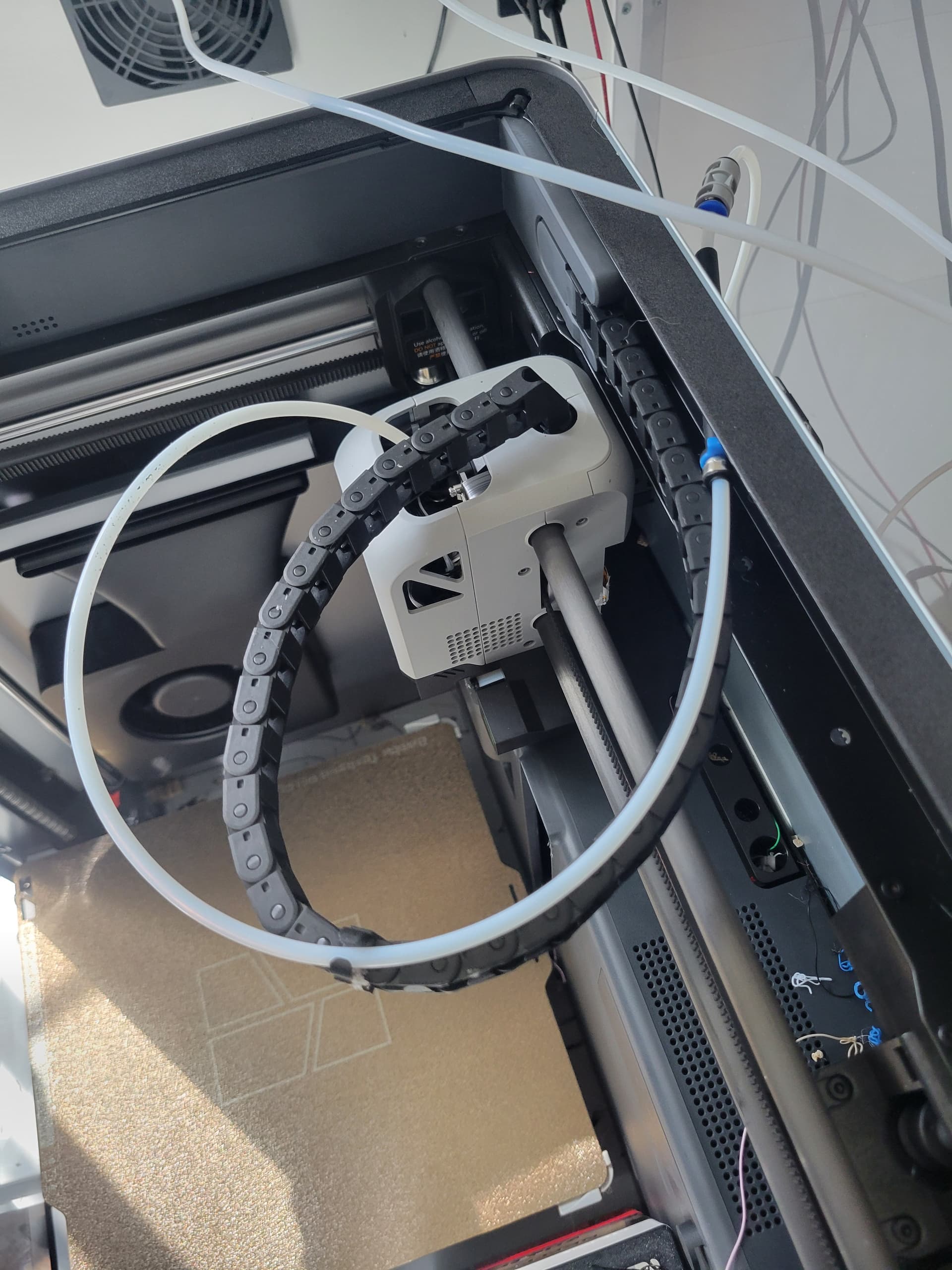

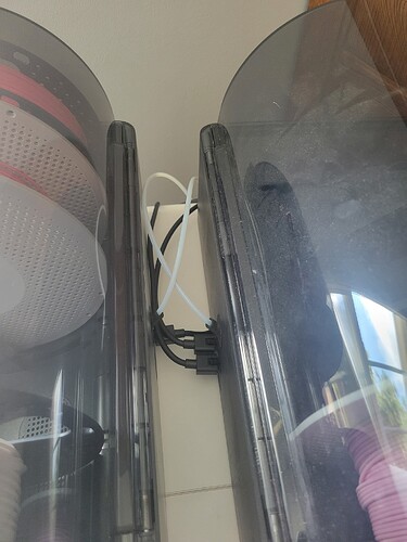

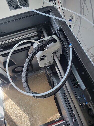

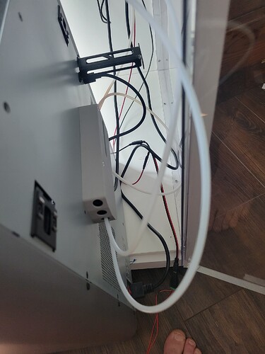

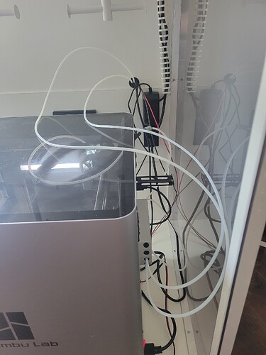

I have had endless issues with filament feeds from my two AMSs. Basically the filament is pushed almost to the extruder but not fully. I think it is related to the placement of the units relative to the printer. When I put everything outside of the cabinet on the floor with short tubes, no issues. Any suggestions? Photos attached.
Shorten the PTFE path.

Shorten the path. You have multiple joins, this is an indicator they are too long.
If your issue is getting it into the head unit like it was for me, after installing this I never had an issue again - Extruder / toolhead PTFE guide for Bambu P1 / X1 by oddsandsods MakerWorld: Download Free 3D Models
The angle of th tubing under the glass caused my issue and it looks the same in your screenshot.
Give it a try.

On a couple of my AMS units I am using longer tubes and they work just fine. The most common problem with PTFE tubes is the radiuses being too tight as you seem to be aware of.

I would unmount the AMS hub from the X1C and put it on direction to the hole, where the ptfe tubes comes into the cabinet. This gives you a smoother and shorter tube path with less bends. The shorter path also helps to speedup load and unloading filament.
It can’t help angles too tight to turn.
You mentioned the issue is getting into the head unit. Your picture shows a similar situation I had that the small guide corrected and I never had that issue again. Give it a shot - takes a couple mins to print and even if its not the root cause, it stops your tube from rubbing on the glass.
