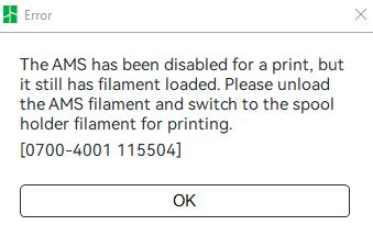

Trying to run a print using my Bambu Lab AMS. I have slots 1-3 loaded with white ABS. I get an error that AMS has been disabled. I checked and seems like everything is loaded. I don’t use it often, so it is disconnected when not using filament from the spool. Using X1E printer. Any ideas on how to enable it?

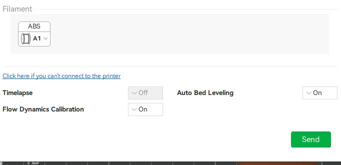

When you send the print, if you click on the filament drop down you should be able to select which filament to use.
Image from this post
Your issue of the “AMS still being loaded” might be because there is a section of filament stuck in the PTFE tube that is triggering a sensor.
This is what I see when clicking on Print Plate
