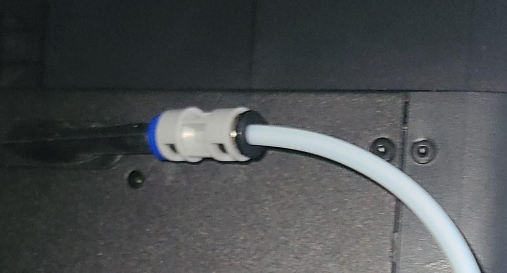

What do u mean push the coupler to pull out the tube? Push that external, cylindrical coupler toward the filament inlet of the machine?
actually is that coupler able to be disconnected so I can take a look at where the filament end is?
This coupler
Not sure if tis photo is indicative of anything, tube-wise.
With any PTFE coupler, like the one in your photo or elsewhere, they are held in place with friction.
To disconnected them, press down the part at the end where the PTFE tube was pushed through, it should move 2-3mm, it will stop when it can move no further.
Pull the PTFE tube out at the same time, it should come out with ease. The grip it has is released when you press it down.

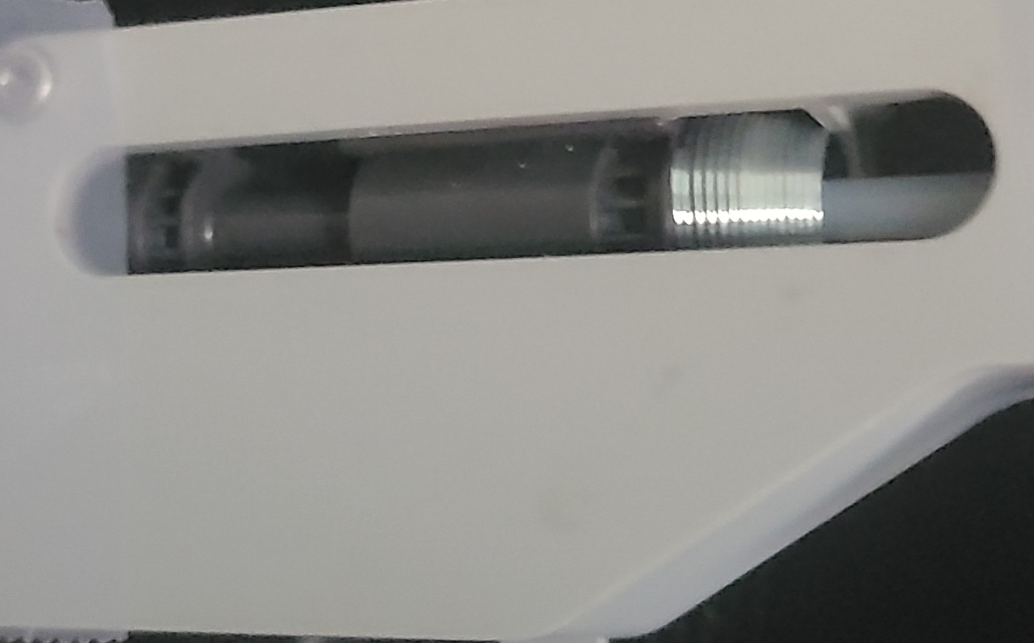

The hub is a different question though as the place you need to get to is actually inside the buffer or hub(depending on what you are using). that is the outpiut (right side).
If you are careful, you can place something like a flat screwdriver in the open channel to apply gentle pressure to replicate the instructions I gave above. The mechanism is the same.
If you are being cautious, unscrew the buffer by the two screws and you can easily manipulate the mechanism.
