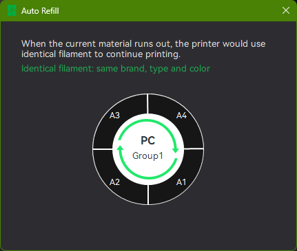

I am printing large parts that use multiple spools, and therefore am using the AMS filament backup option. I have a lot of leftover spools that I use up in my AMS, however the spools no longer switch in the order shown on screen. (If I start a print from slot #3 it switches to #1 after emptying) Could this be corrected? Otherwise I have to do a lot more swapping - introducing unnecessary moisture into the AMS. The green arrow is no longer indicative of the order that they get swapped.

For auto-refill, the AMS will use up whichever spool you select as your original source when printing; then go to the lowest numbered slot with the same filament, then the next higher numbered slot with the same filament, etc.
The graphic is a bit deceptive in some circumstances - namely, if you’re starting with either slot #2 or #3. The graphic is correct if you’re starting at #4 or #1.
In other words, it wouldn’t go 3 - 4 - 1 - 2, it will instead go 3 - 1 - 2 - 4.
Yes, I’m aware of that - I guess what I’m saying is that the PC(in this case) group rotation does not continue from A4 to A1 - as the green arrow suggests.

I would like to see the rotation order adjusted so it follows the arrow, else the arrow should have a starting point at A1 ending at A4, for the sake of clarity.

If they we have a flat/linear graphic listing the order as left to right, instead of a circular one showing a rotation, it would make more sense.
