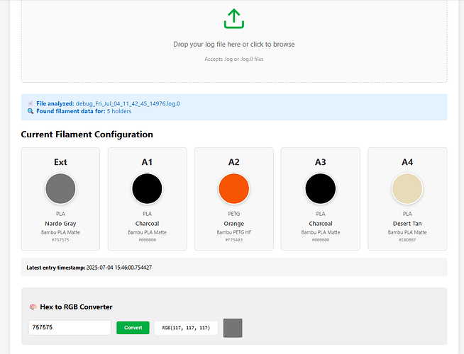

So figured I would cobble together a simple little HTML/JavaScript app to show me the filament type and colour that’s currently loaded. I’m not going to claim to have come up with this idea, that thanks goes to hong823 who posted on the BambuLab subreddit:
https://www.reddit.com/r/BambuLab/comments/1evdf33/determine_filament_color/[Determine Filament Color? : r/BambuLab]
Inspired to take it further and show the colour name/type I came up with this
Open the webpage, click browse, search for and find the latest debug{todays date}.log.0 in C:\Users{username}\AppData\Roaming\BambuStudio\log and it should display what you have loaded.
Also popped an RGB Converter at the bottom for when you’re using Ext spool and need to put in the exact RGB value based off the hex code.
I may look at autoloading the .log.0 file to save time. If anyone’s interested I can share it from my github repo.

Will still use my tool I think for those times I just need to know what colour is loaded in the AMS as there are a few “greys” and “whites” that I just can’t tell the difference from BLs colour swatch.
