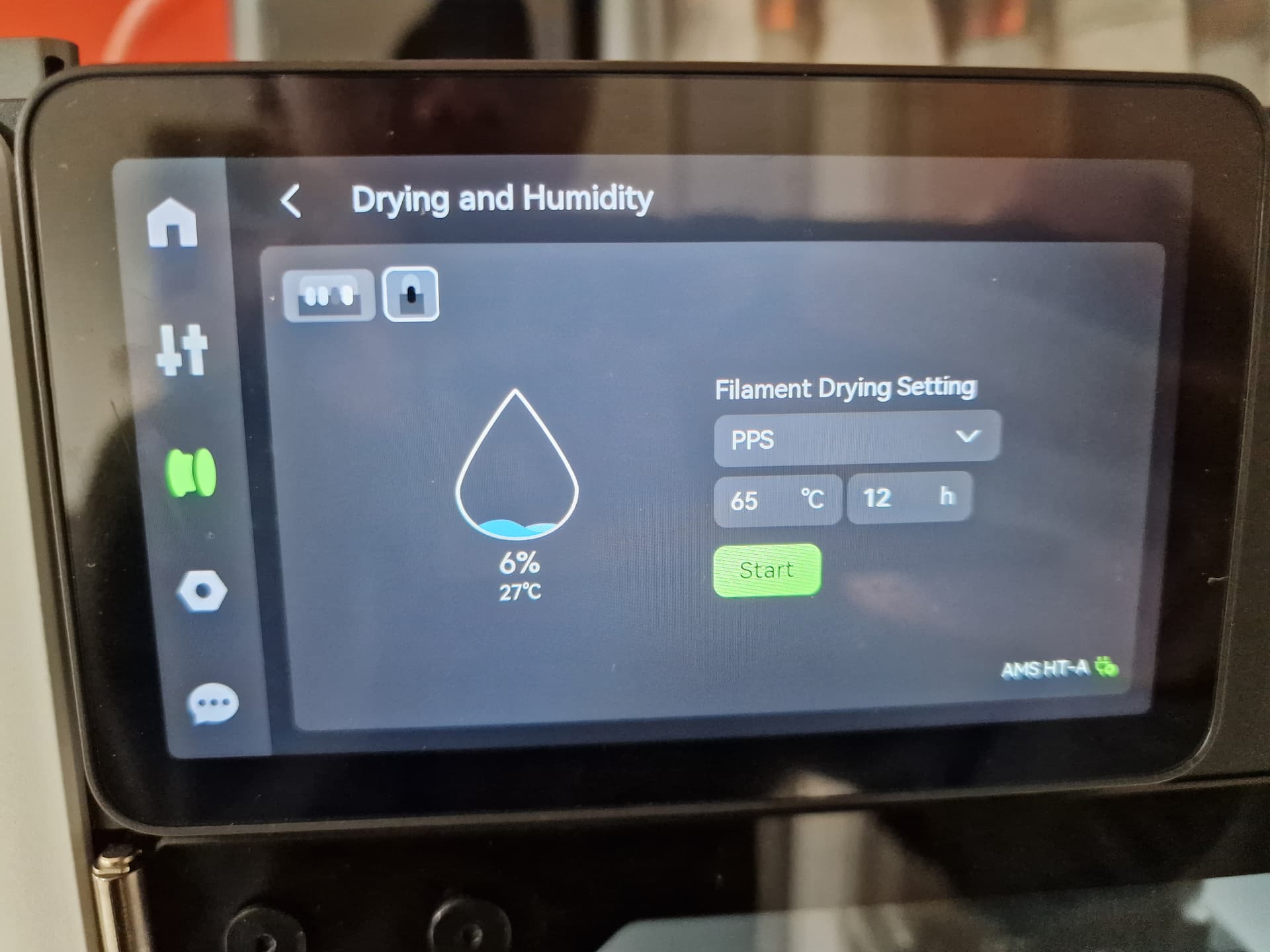

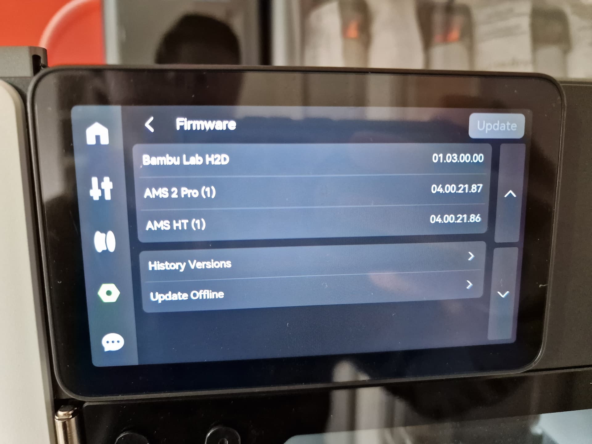

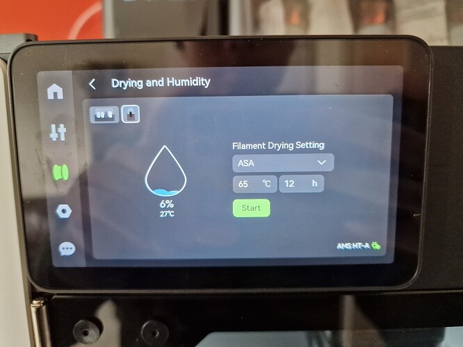

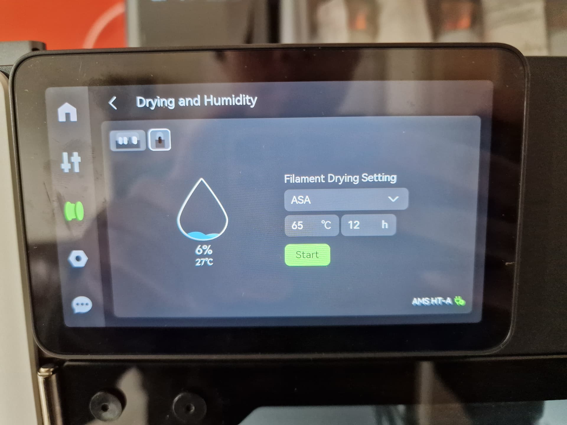

Not sure if anyone else is having this issue, After the latest printer and AMS firmware updates, the AMS HT drying temperatures are all capped at 65 degrees, even for ASA (should be 80 degrees) or any other high temperature material. I have factory reset the machine and it has not helped, it’s quite annoying to have to manually look up the correct temperatures and enter them.
I’m currently drying some ABS at 81 degrees in my AMS-HT with a P2S…
My AMS software is different to yours though, 03.00.21.29, I added my second AMS-HT about a month ago and it updated then. This thread may explain why: Just received my HT, but the firmware? - Bambu Lab AMS / AMS HT - Bambu Lab Community Forum
You should be able to enter the correct temperature still, it’s just the defaults are wrong. I’ve noticed this as well, I think it was part of the print while drying change that got them out of sync. Either the printer is right or the wiki is right. They dont match. I double check every time I need to dry just to be sure.
I noticed it changed with the update as well. But just tried it from the app and ABS was preset at 80 for 8 hours. Litterally just started another one from the printer and it was 65 :man_shrugging:t2:
