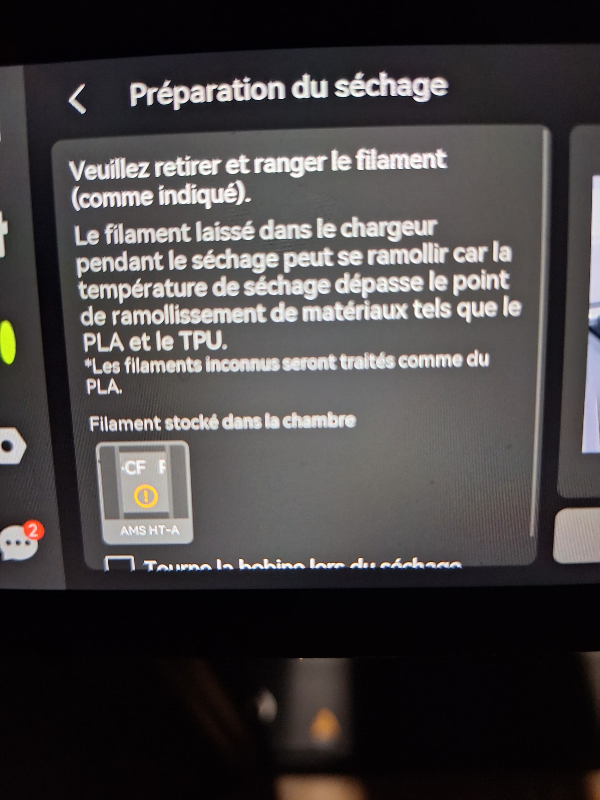

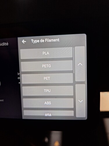

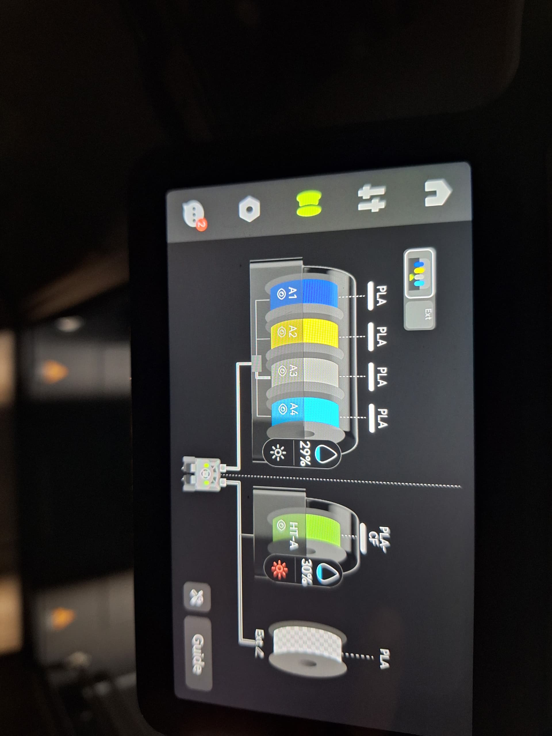

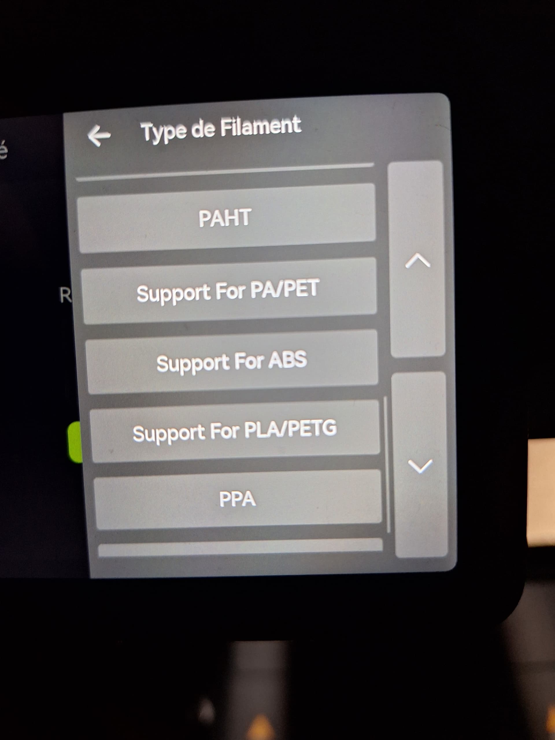

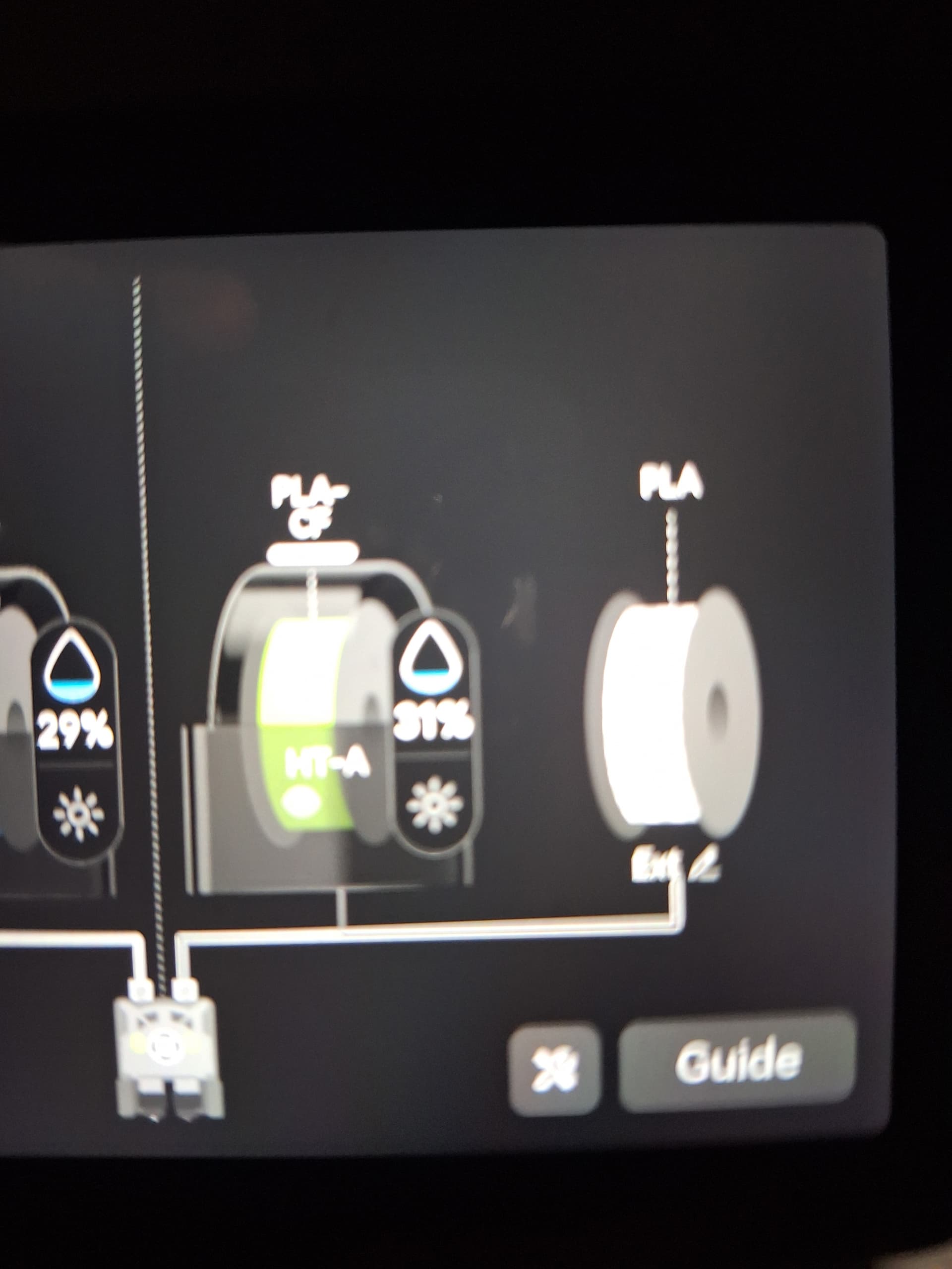

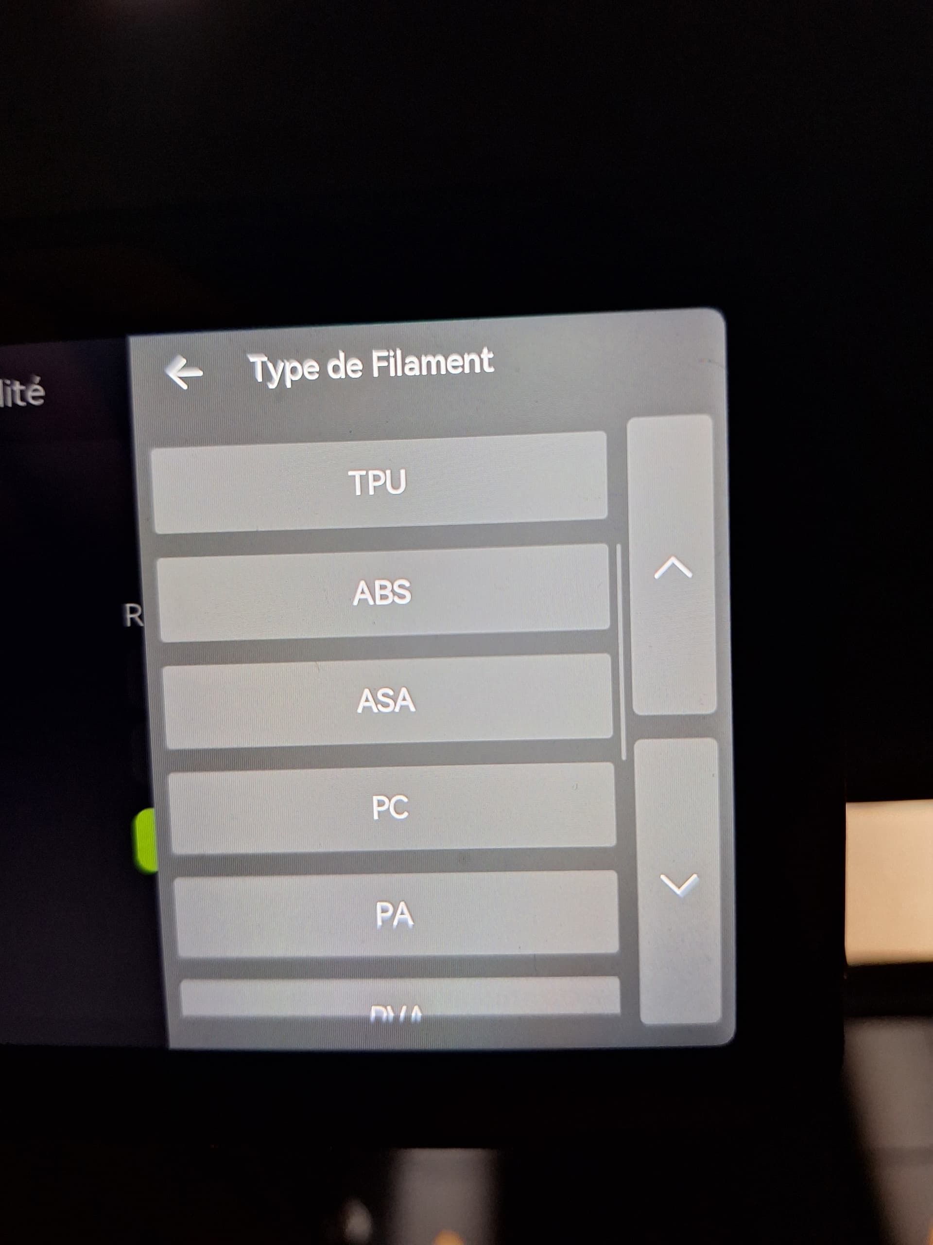

hi
i just received AMS HT for drying PLA-CF and ABS, but
he recognised AMS and PLA-CF!
but not give me choice or right to dry it for?
all is up to date, so maybe existe process to made before for tell him,

Because PLA-CF is PLA as far as drying Temp and time is concerned.
45 max!! pla-cf dry to 55 or 75 in box
must do twice for
I would not dry PLA-${anything} at 75.

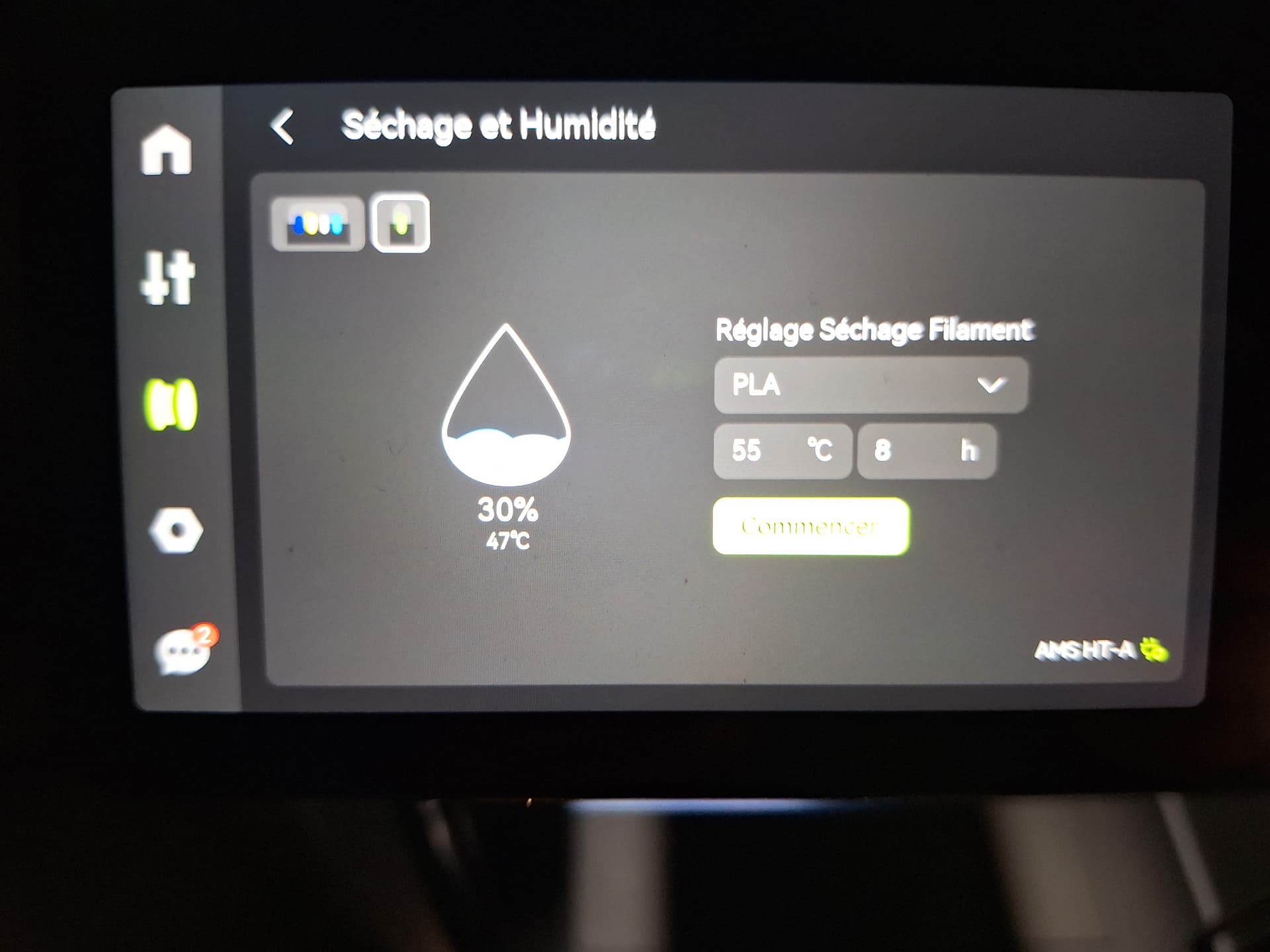

It’s not forced to 45C unless you leave it inserted. It used to be 55C but we all asked to be able to dry with the filaments inserted, so it now default to 45C for all PLAs (basic, matte, silk, CF) to avoid issues when inserted but if you unload the filaments from the funnel, you can set it to 55C and select rotation
try it soon, in work now!! made guitar support but i not remember me will be loaded!! just put inside and try dry and tell!!if filament be not recognised, ht considered it like PLA
