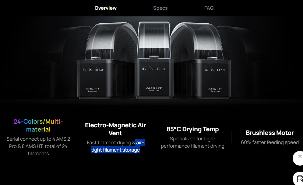

Nope. You are not missing anything here. AMS HT is not sealed well enough. Mine and many people on this forum experienced the same problem.
One of several instances of BS marketing:
Coincidentally, those people also live in a low-humid environment :wink:
It’s 55% humidity in the room (Basement) right now and 84% outside for the last week although its dropping today. Thats not desert dry. There may be other factors involved for some, but I have not had any issues with keeping filament dry in cereal boxes, 3D Printed spool holders or AMS 2s or AMS HTs.

I am sure they are not lying, but they don’t say what they qualify as their concept of “Air tight filament storage” so I presume it’s different than yours.
