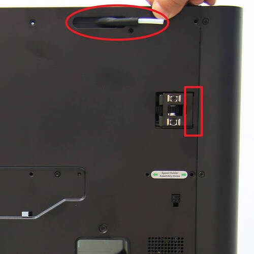

There are two ways the P and X series receive filament.
You have spoken of the Buffer and the Hub, that is the main way.
The alternative way is the external port.
RED TOP RING
