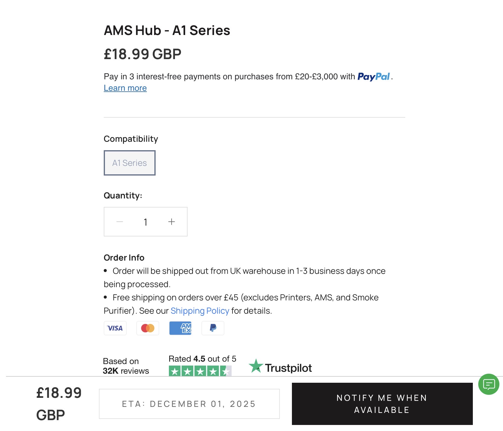

Here in UK it now says ETA 1st december next to the Notify me box

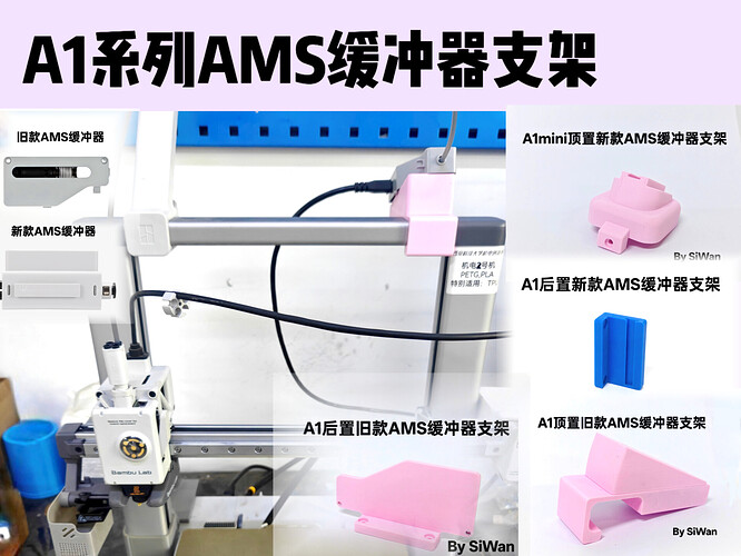

For information, you can use the old AMS buffer from a P1S or X1C on the A1, just tested it on 01.07 and connected a AMS HT with P1S buffer to A1 Mini, not sure about the old 4 port hub, not got one to try
Sorry but I can’t understand what HUB you’re reffering…can you post a link? In any case how do you manage the 4-pinned A1 connector with the 6-pinned AMS??
This buffer, it already does 4pin to 6 pin conversion
Uh ok got it thanks…and you’re 100% sure it works with the A1 Mini? I’m asking because tomorrow I’ll order an AMS2 pro but the proper hub is not available and the customer service doesn’t know when it will be…in any case what are the differencies between this HUB and the “official” A1 Hub, then?
I’ll try an AMS 2 in a bit, but the main difference is that the old Buffer only has 1 input, the new A1 Hub has 4 inputs, I guess this would be the equivalent, but costs a lot more
Uh ok, so, in theory, if I’m not interested on having more than an AMS 2 Pro it’s irrelevant to use this one or the official one, right?
As far as I can see, yes, there are even mounts designed already, I will now not bother with the new one, only want to use my AMS HT on the A1 Mini, also the drying function worked, I like the HT because it has a mains input built in.
Hi again, as far as I understood, you’d like to test this buffer with the AMS 2 Pro and an A1 Mini, right? In case could you please ping me when done to let me know if it works? Thanks!
Just connected to AMS 2 and it worked fine, guess you would need external power supply for drying

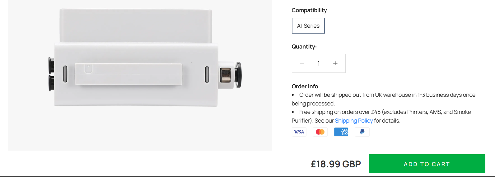

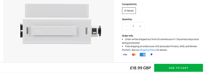

The ams hub for the A1 is now in the uk store
So it is, did say 1st December, ordered mine :sunglasses:
