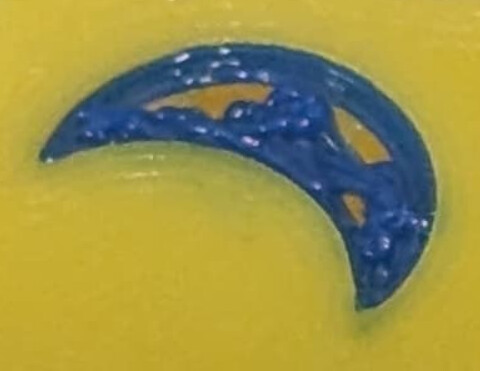

I’m trying to print a 4 color design (with PETG) on my A1 with the AMS Lite. Here’s what it looks like:
As you can see the larger areas of the Blue aren’t fully covering their areas. The smaller sections (and even a few of the other larger areas) look Ok. Trying to determine what I can do to get this to fill in better. If I up the Flow Ratio a bit for the Blue could that help to fill these in? Any other options for trying to correct this? Appreciate any guidance. Thanks.

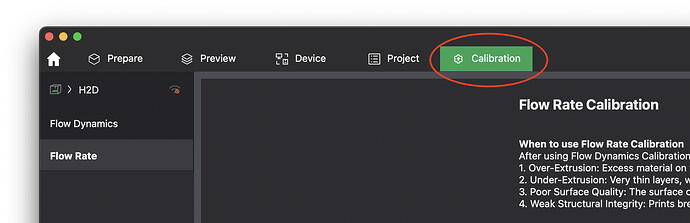

But try to run both flow rate and flow dynamics calibration in Bambu Studios calibration tab.
Not sure I understand your statement about running flow rate & flow dynamics calibration in the Calibration tab. Where is that? I see the Calibration button on the Device tab but there’s no flow rate or flow dynamics there. My plan was to up the Flow Ratio in the filament profile by 5% (currently at 0.95, increasing to 0.99).

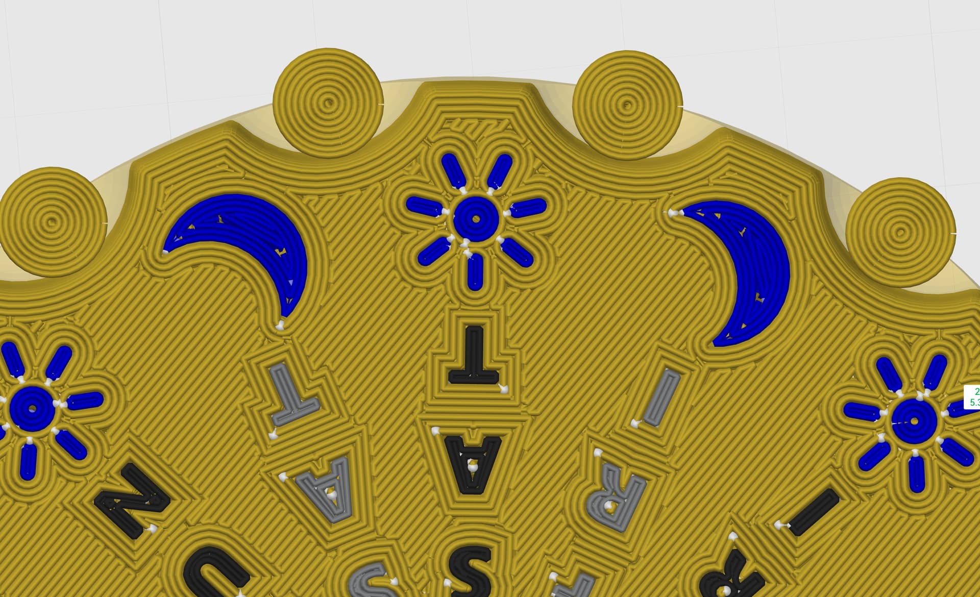

When I slice this, here’s what it looks like:
Looks like it’s not filling the areas as completely as I’d like. Again, guessing if I increase Flow Ratio that should help to fill this in. But not sure what this will do to the Blue areas that currently are filled pretty well. Are there any other options?
You will find the calibration options here:

But the slicer image suggests that I’m looking at the initial layer, right? If so, this would indicate an adhesion issue. Try to increase the initial layer flow ratio after you calibrated your filaments. Rinsing your build plate with warm water and soap is also worth trying.

It’s actually layer 2. The Blue is on Layers 2 & 3. That’s the only place Blue is used on this print. I always wash my build plate with soap & warm water between prints.
Does this mean that you are trying to print the blue parts in thin air?
You should try to either have this on the top side or make it flush with the bottom.
It’s not my design and has been printed by others without issue. It’s just 1 layer, so I wouldn’t necessarily say that’s printing in the air. All the other colored areas (all on layers 2 & 3) look fine so really don’t think that’s the issue. I guess I could cut off that bottom layer and move all this to layer 1. Still printing the test to see what it looks like with the flow ratio increase. If that still looks bad, I’ll try cutting that bottom layer off and see if that helps.
A 0.2mm distance increase is quite a bit, especially for an initial layer.
You would have to set your flow ratio to 200% to compensate for this missing layer, but that would come back to haunt you in the following layer.

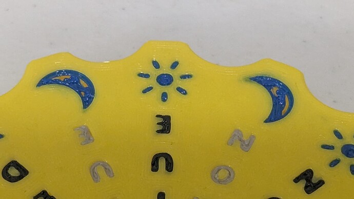

Printing color islands in the air (no bridging and no support) will leave you with artifacts. This is even visible in the review photos on the model on MakerWorld.
Thanks for the pointer. I did focus on the pic (which indicates material underneath the blue) and was a bit baffled about the flow recommendation.

Fortunately, @sealyons was able to synch his AMS and hence print using the profile by his comments on MakerWorld.

Yellow is printed first. I also made a series of changes to the Process profile including reducing Outer & Inner Wall Line width to 0.35 mm, slowing inner & outer wall speed for the first few layers, reducing acceleration (but not as much as suggested), etc…
Trying to complete the print and will post an image of the results once available. It’s not perfect but better.
