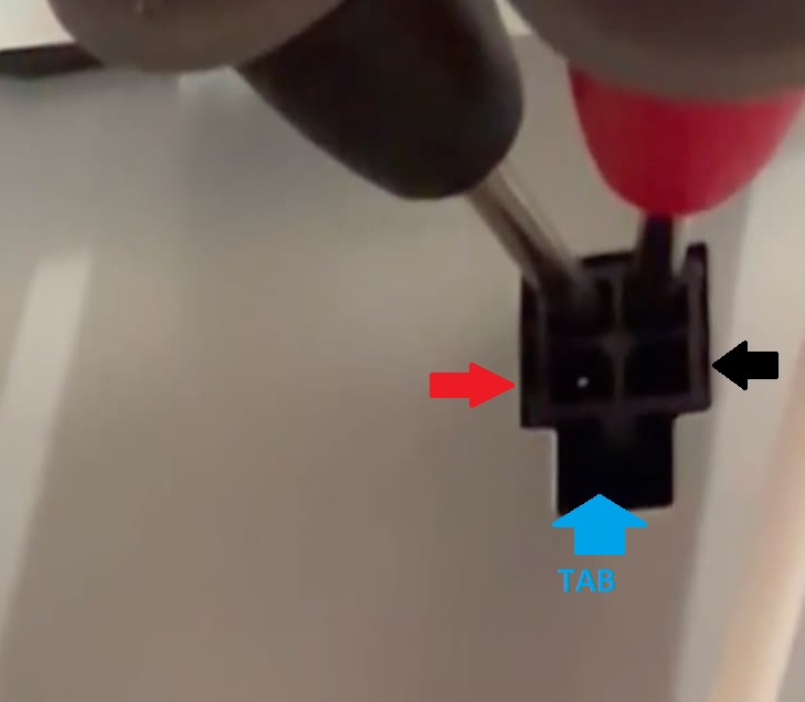

Thank you for the pictures.
I’m pretty sure you’re checking the wrong side/pins of the connector. The power pins are on the tab side of the connector.
