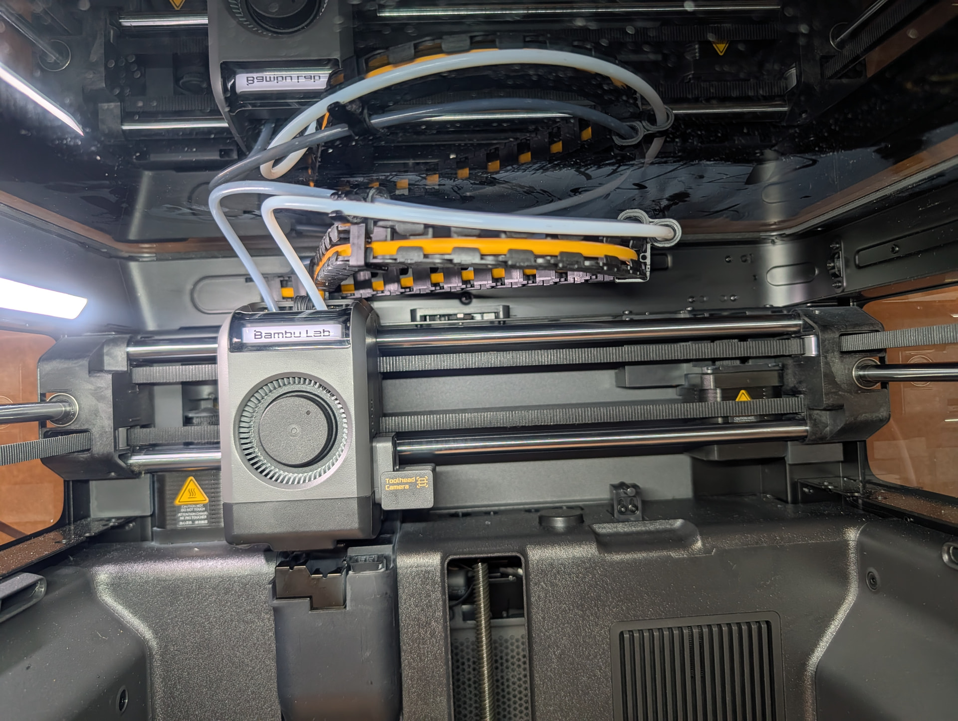

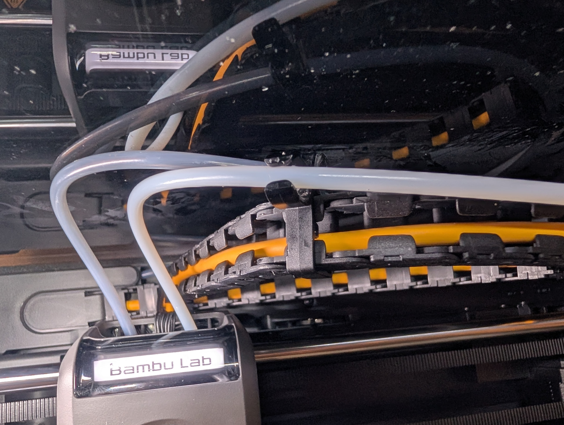

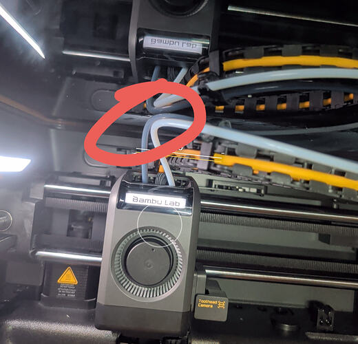

  • Visual Inspection of the Tube: I took a photo of the toolhead when it is parked at its starting point. The newly replaced internal PTFE tube forms a very aggressive, tight bend/kink right where it exits the cable chain and enters the toolhead.

  1. Does anyone have reference photos of the correct factory PTFE tube routing/length for the X2D left hotend when parked at the scrubber? I suspect my replacement tube is the wrong length and creating too sharp of a bend.

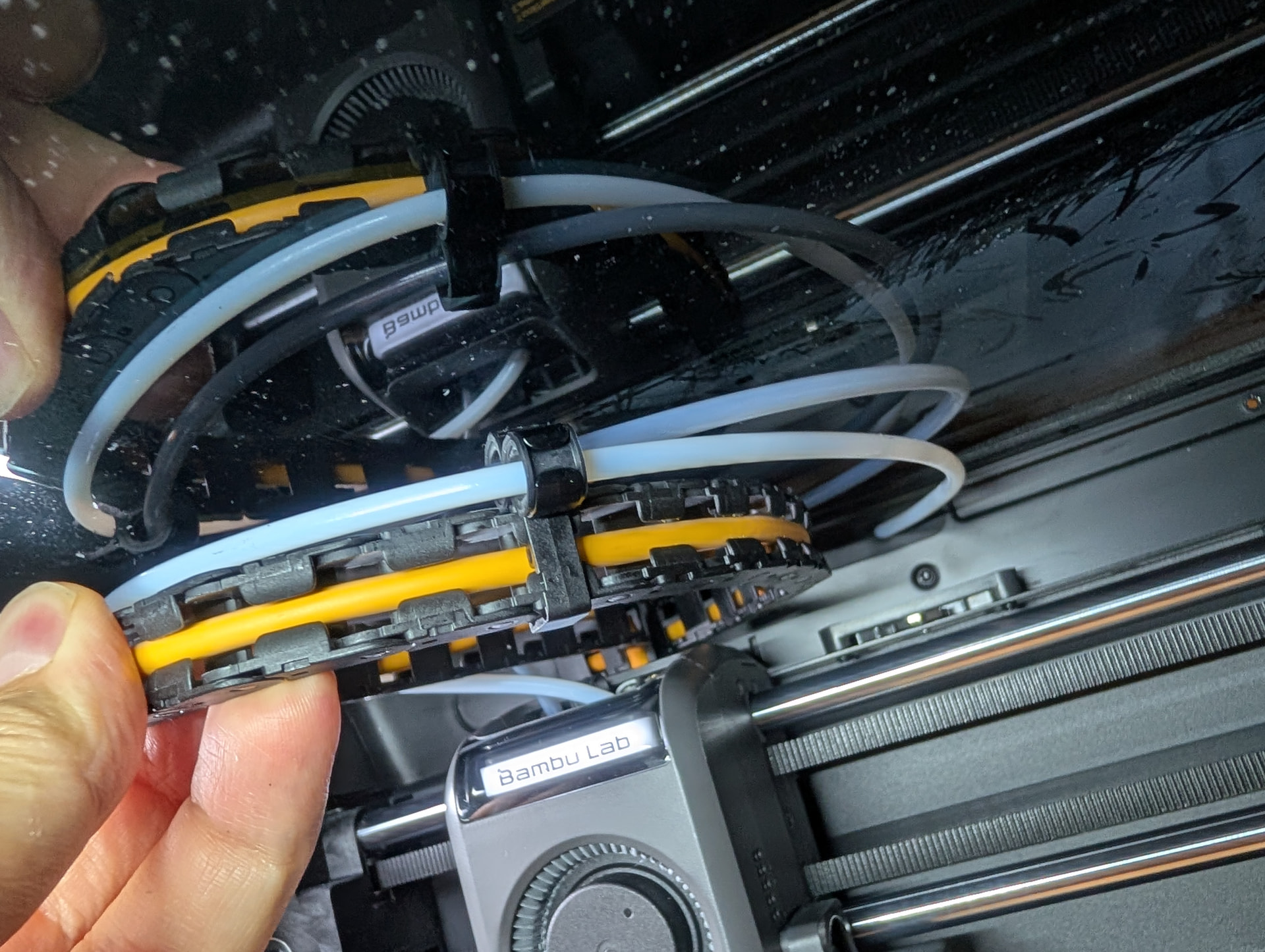

O am not able to make mines look like yours. Not sure how to do that. And one of the clips have open loop for aux line in mines
Your PTFE tubes look to be too long. Try cutting 10cm off and test. Cut again if needed, just don’t go too short or you’ll need to replace them. My X1C was the same way, I ended up cutting off about 20cm if I recall and it really improved or reduced the friction…
Never thought of this. Will definitely worth trying as I have some spare PTFE tube ordered from Bambu. Its in different color, but hopefully it does not matter.
Haven’t yet made a single cut. Is using scissors good or beter that scratch tool from Bambu or else?
P.S. looks like there is reference with requires lengths in Introduction to Bambu Lab PTFE Tube | Bambu Lab Wiki
Was yours off before cutting? Or you cut smaller than reference?
At the time I didn’t check for the required lengths. I just used some common sense, your pic shows a really tight bend just before the extruder, it needs to be more gentle. I did make sure the tube was in the clips and or chain properly but in the end cutting mine just a little bit made all the difference for me.

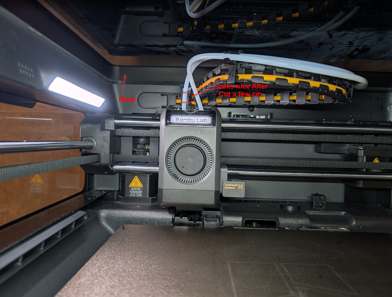

Another thing to consider would be a riser for your top, that can make a big difference as well, keep in mind I’m suggesting this based on my X1C, I’m sure the P2S suffers the same problem, there really isn’t enough height for the tube(s).
Riser. Another excellent idea. Started researching which To print faster with 0.8 hf head :slight_smile: Hope p2s risers are compatible with x2d

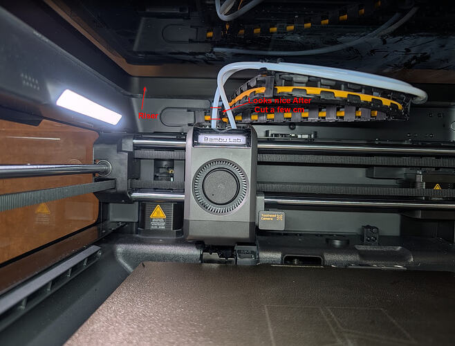

Updates since last post
So I printed a riser X2D + P2S -flat riser V3 +storage compartment +seal - Free 3D Print Model - MakerWorld

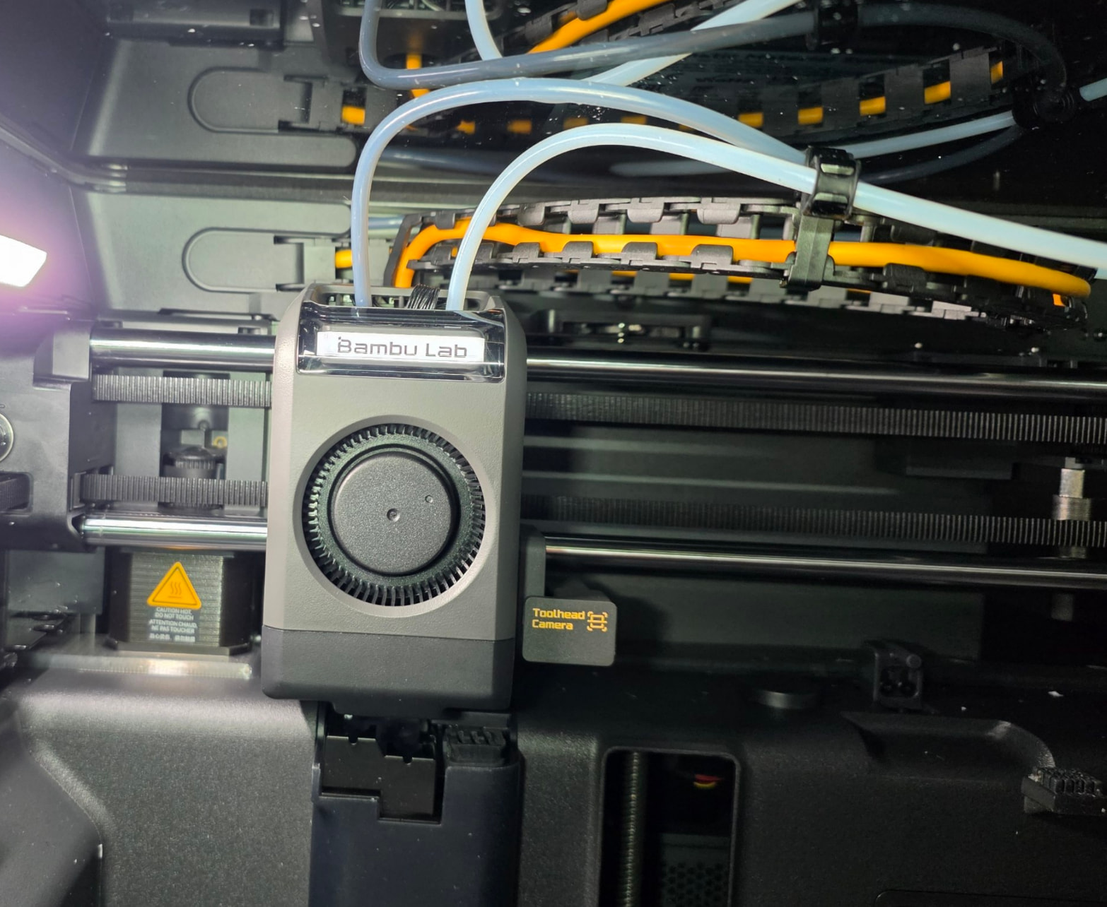

Then cut main extruder ptfe tube from printer entrace to pringing head.
Inside after my changes:
