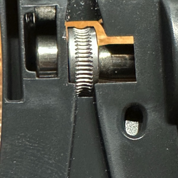

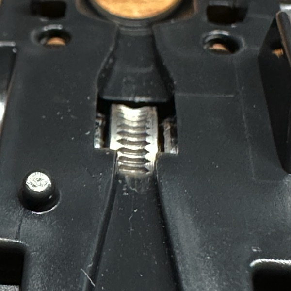

Sounds like a lot of new X2D owners are having the same problem with the AMS hub component. I took mine apart to look for clogs and didn’t see anything. Upon closer inspection, this is what I’m thinking:
Top wheel, looks perfectly centered:
Bottom wheel, not quite so centered:
Imagine AMS slot one feeding in from the left. It’s hitting the right edge of this gripper wheel and getting stuck. At least that’s what I’m going with. It makes it so you can’t do a 4-color print without hovering over the printer. And even then, I get frequent warnings from the AI assistant that the filaments are all experiencing high tension, to the point where it stops printing and makes me check for overlapped filaments on the spools, which there are none.
