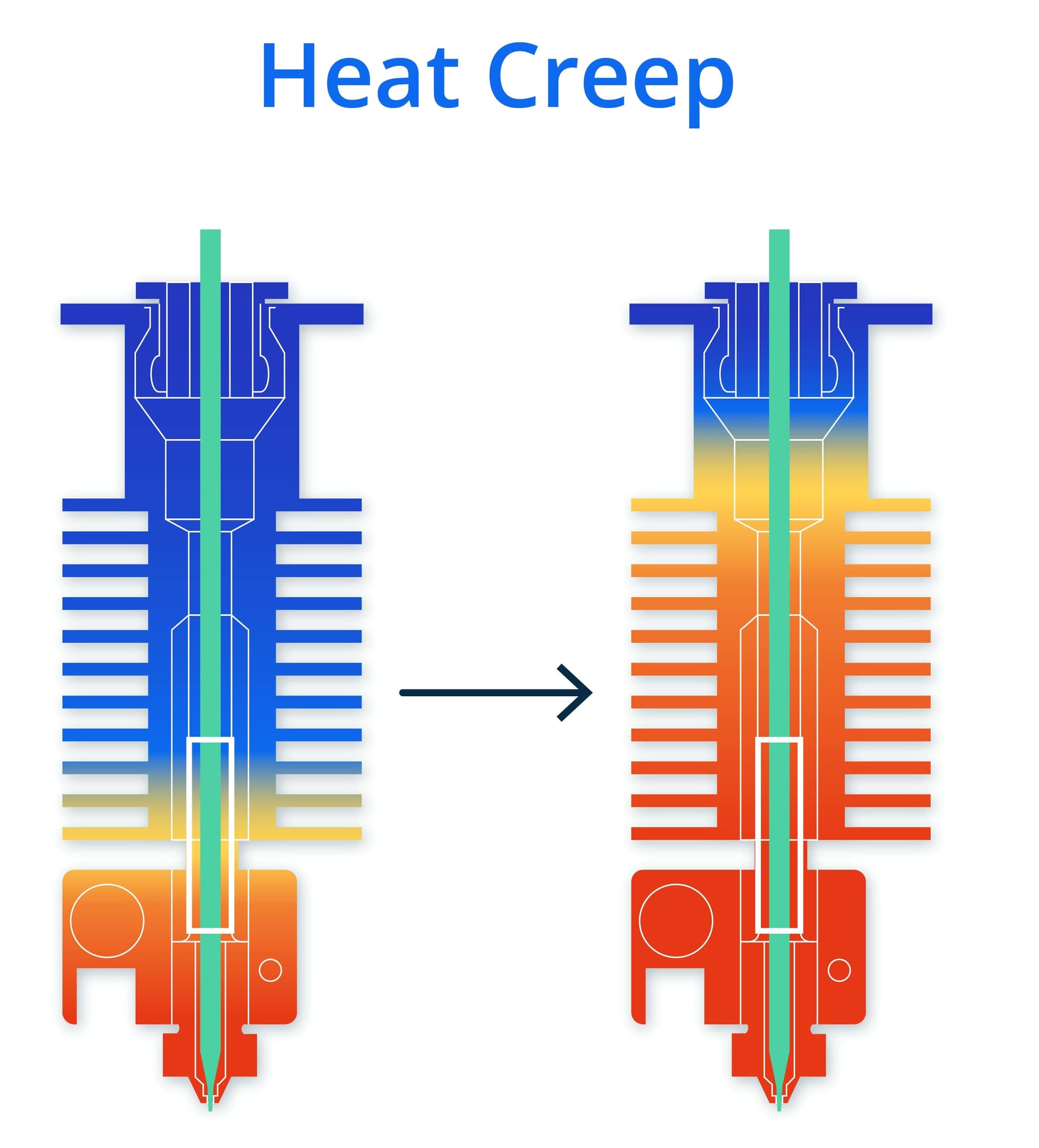

It does sound like heat creep from your description. What’s you chamber temp? I usually aim for 35-39°C with PLA, up to 35° with many retracts and below 35° wirh ironing.

Thank you very much for responding. I am not familiar with heat creep terminology and what causes it. It has been a bit warmer here in Boston but I print in an air conditioned room at 74 deg.
I installed a new complete hot end and new hardened steel extruder gears and the next print failed. I have a P1S printer so do not have control of the temp inside the printer. I will check all the settings and see if there are any changes that I have made inadvertently.
Here’s an older explanation of heta creep. Note that a cooler chamber is better for heat creep preventiin but worse regarding warping/curling.

Here is a graphical description of heat creep.
