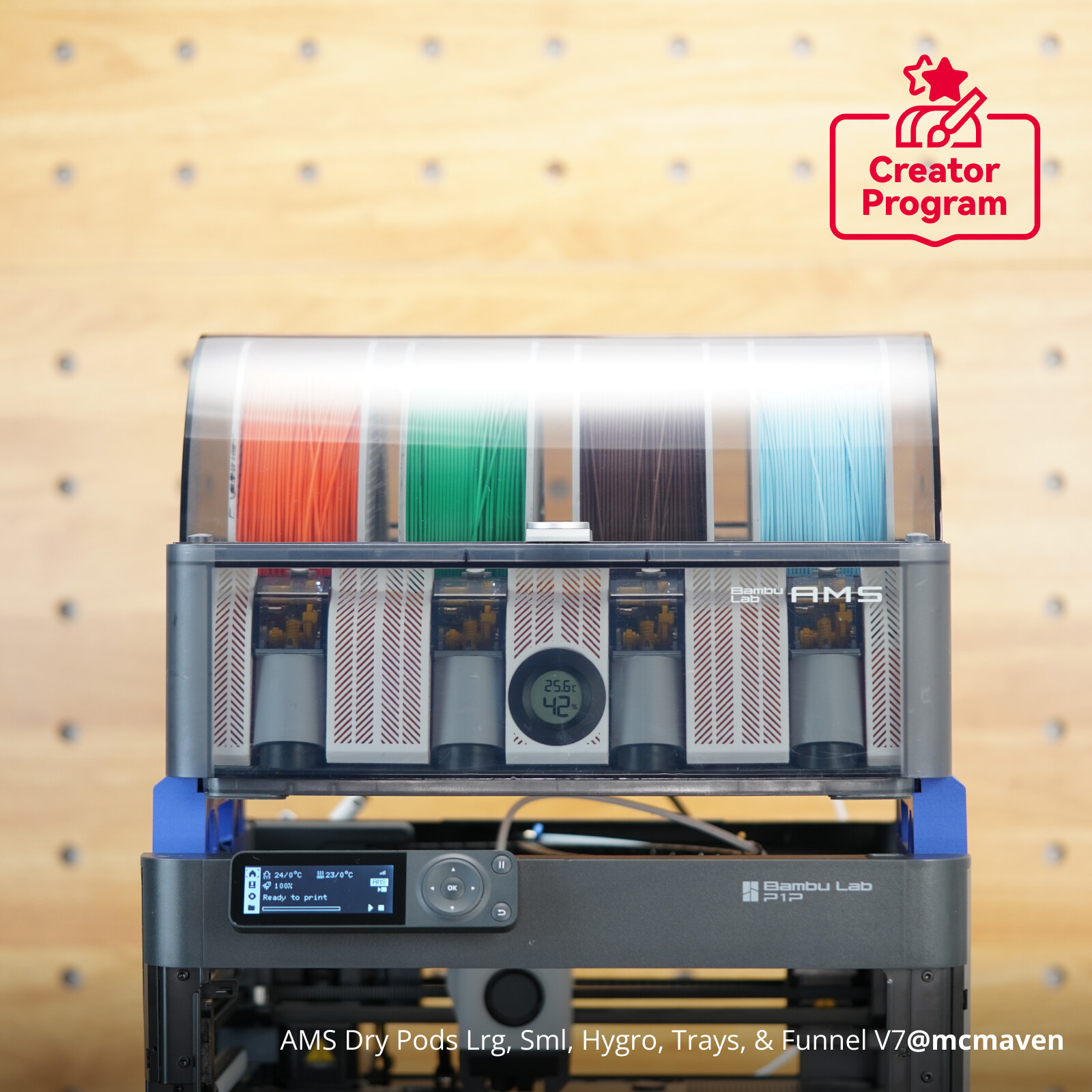

As your post indicates you have an A series printer, you AMS is the lite version.

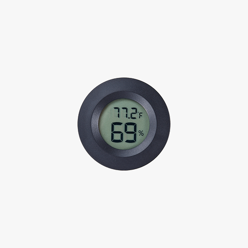

You can add a printed AMS lite enclosure, known as the “Ultimate Filament Spool Enclosure for AMS Lite” which also allows for embedded Thermometer & Hygrometers to monitor the ambient levels that can affect your spool’s current levels.
If your filaments have moisture in them, you will need to dry the filaments to stop them being brittle. Your print quality should also increase and other related problems should reduce.
I recommend reading this, the examples shown are extremese, yours may be different.
https://wiki.bambulab.com/en/filament-acc/filament/dry-filament
For those with any other version currently sold, the following is true for the AMS or AMS 2 Pro.
If you have not added a humidity display to your AMS, I recommend you do so.
You should also add desiccant containers in the printer as well and fill them with silica gel. This will not dry out your filament, but it will slow down any moisture being added.
