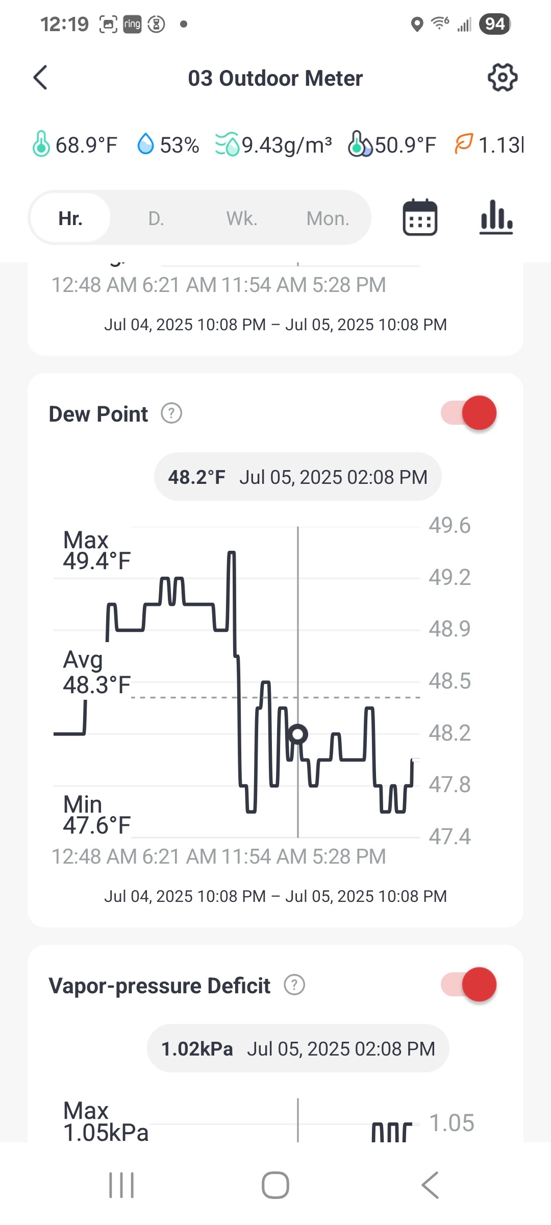

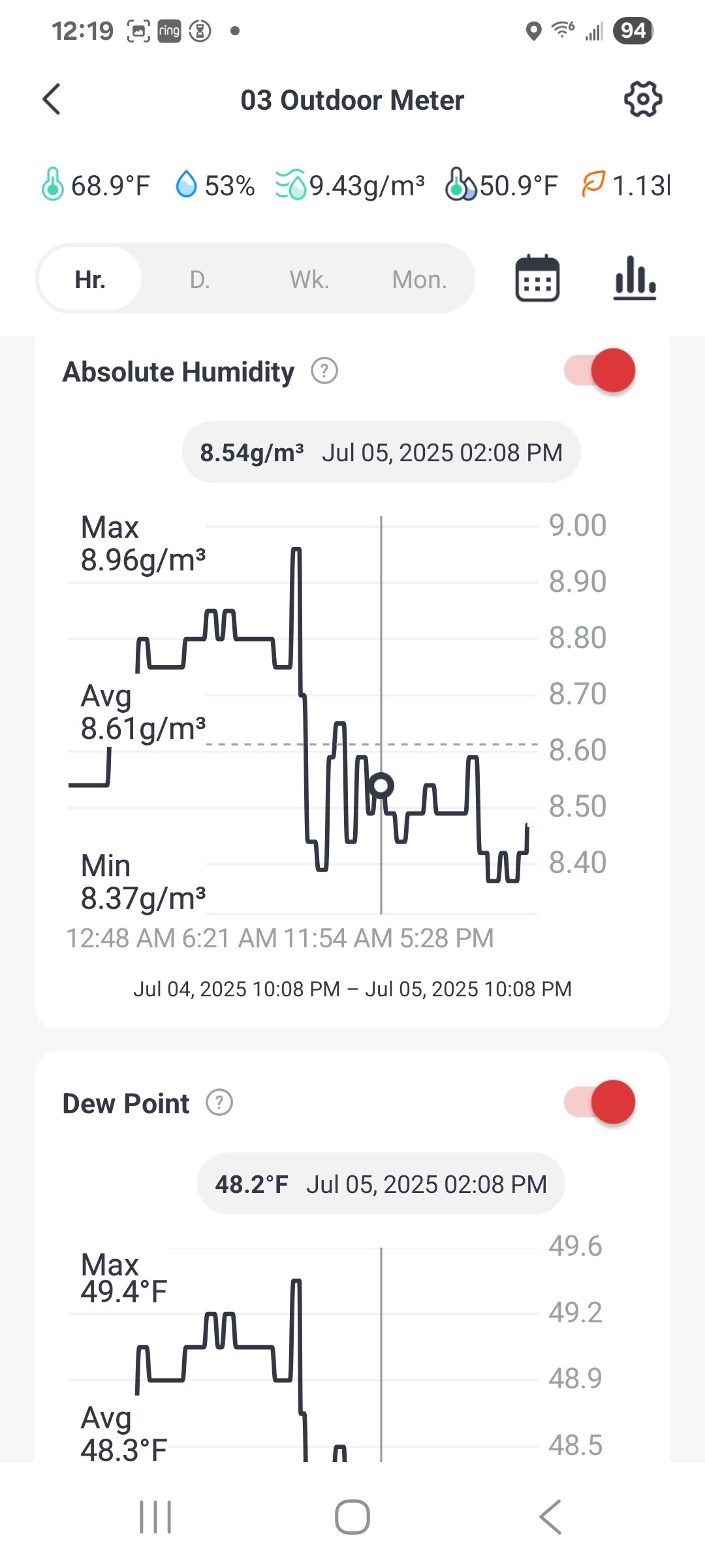

Btw, maybe it’s obvious to some or maybe it isn’t to others, but the shape of the absolute humidity graph is the same as the dewpoint graph:

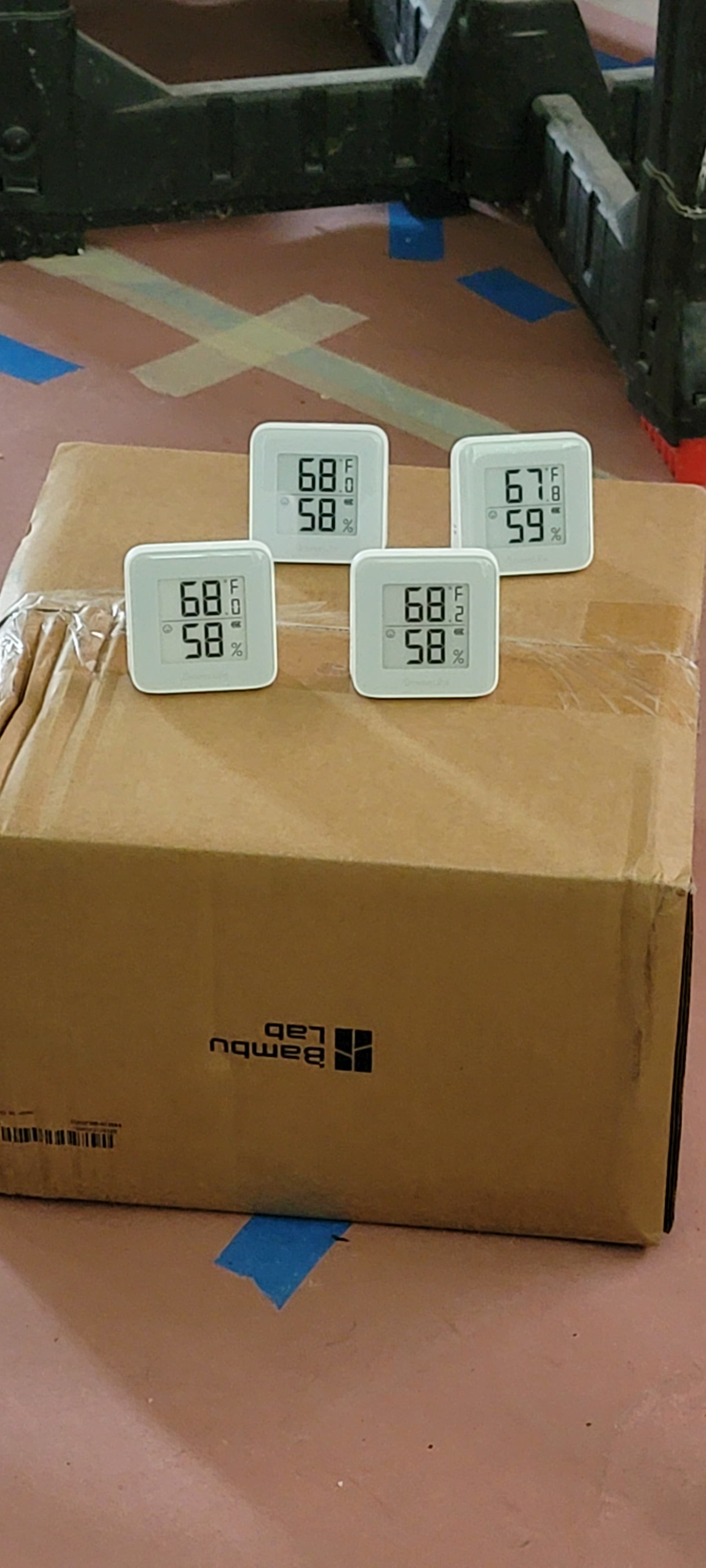

Switchbot has both, whereas govee only graphs dewpoint. However, the eink displays on govee are far easier to read
Very crisp, even in low light.
Yolink used to graph dewpoint but seems like it no longer does. I’m rather disappointed that yolink’s automatic firmware update was a downgrade in that regard. The main advantage of yolink is extreme range. You’ll practically never miss receiving a packet.
