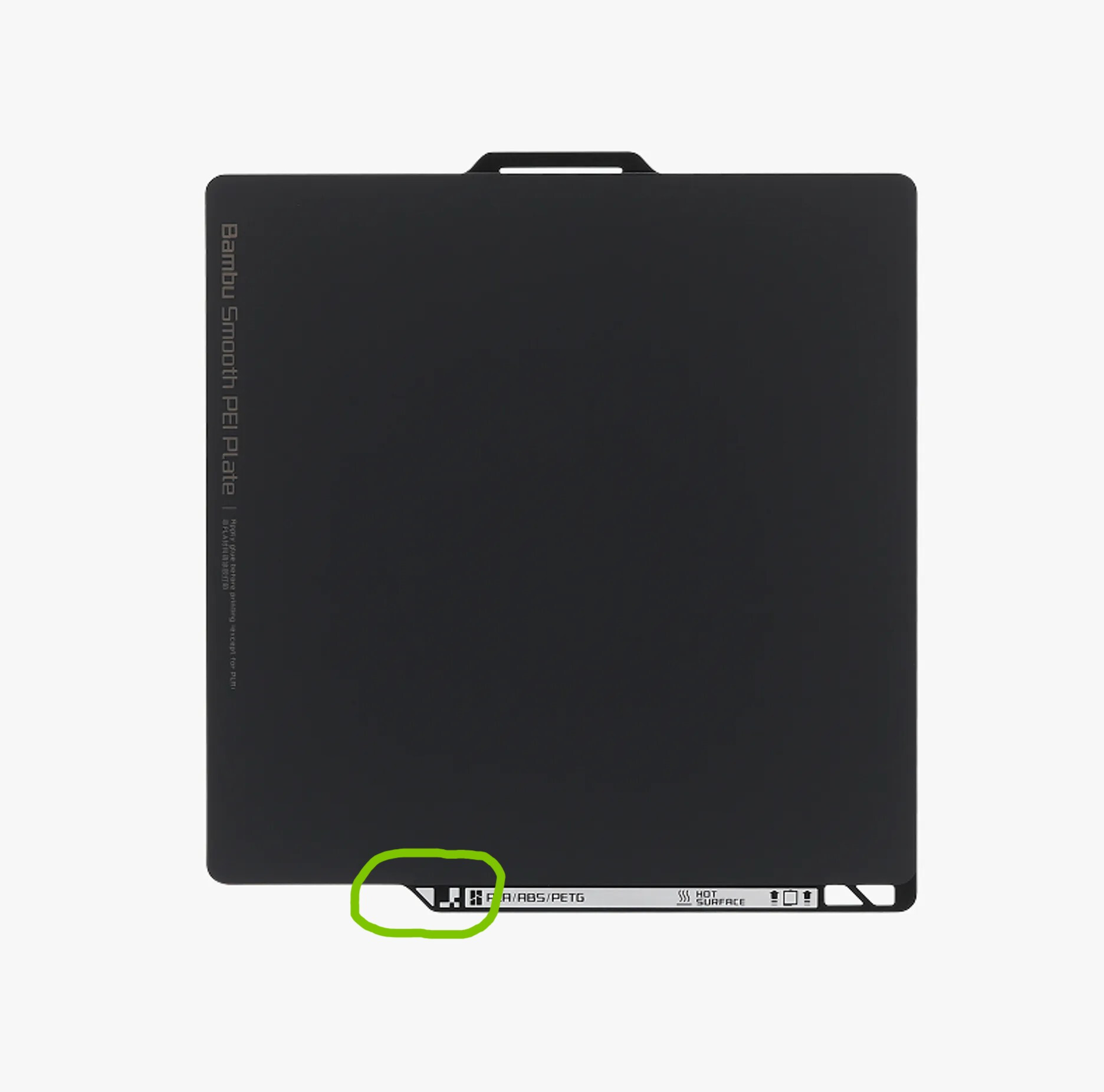

  2. When i bought my P2S i also bought a smooth build plate with it since i prefer to have that one when printing cosplays and as People know, there are 2 versions of that build plate (the difference being that the newer one has the QR code for the P2S and newer system to check the build plate. When it arrived i kept getting error messages that the build plate was not detected, turns out i was send the first gen build plate, contacting support about this topic turned into a bit of a nightmare, they tried to make me believe that only the texture plate would have a second gen version (the Wiki says 3) and they were really stuck on that answer, after a few days i was almost about to loose it, but then i noticed the difference in the build plates and was able to proof to them that the first generation was sent to me. i got send the new version and as compensation they told me that i can keep the other build plate aswell.

Your comment about ā€œgenerationsā€ of the build plate is interesting to me, what do you notice between the two? Can I trouble you for a picture comparison, if the plate’s surface material is significantly different?
the first picture shows the first gen build plate and the sedond picture is the second gen
size and material are all the same, the only difference is the green marked mini qr code the the P2S Camera can read
