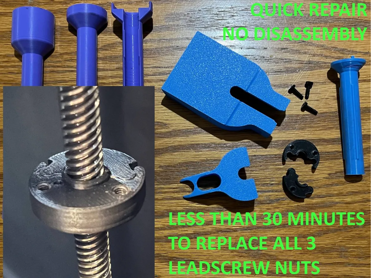

I have been working on a repair kit that will allow replacement by a 2-part nut without any removal. I am still running some tests to validate it but it shouldn’t take too long :slight_smile:

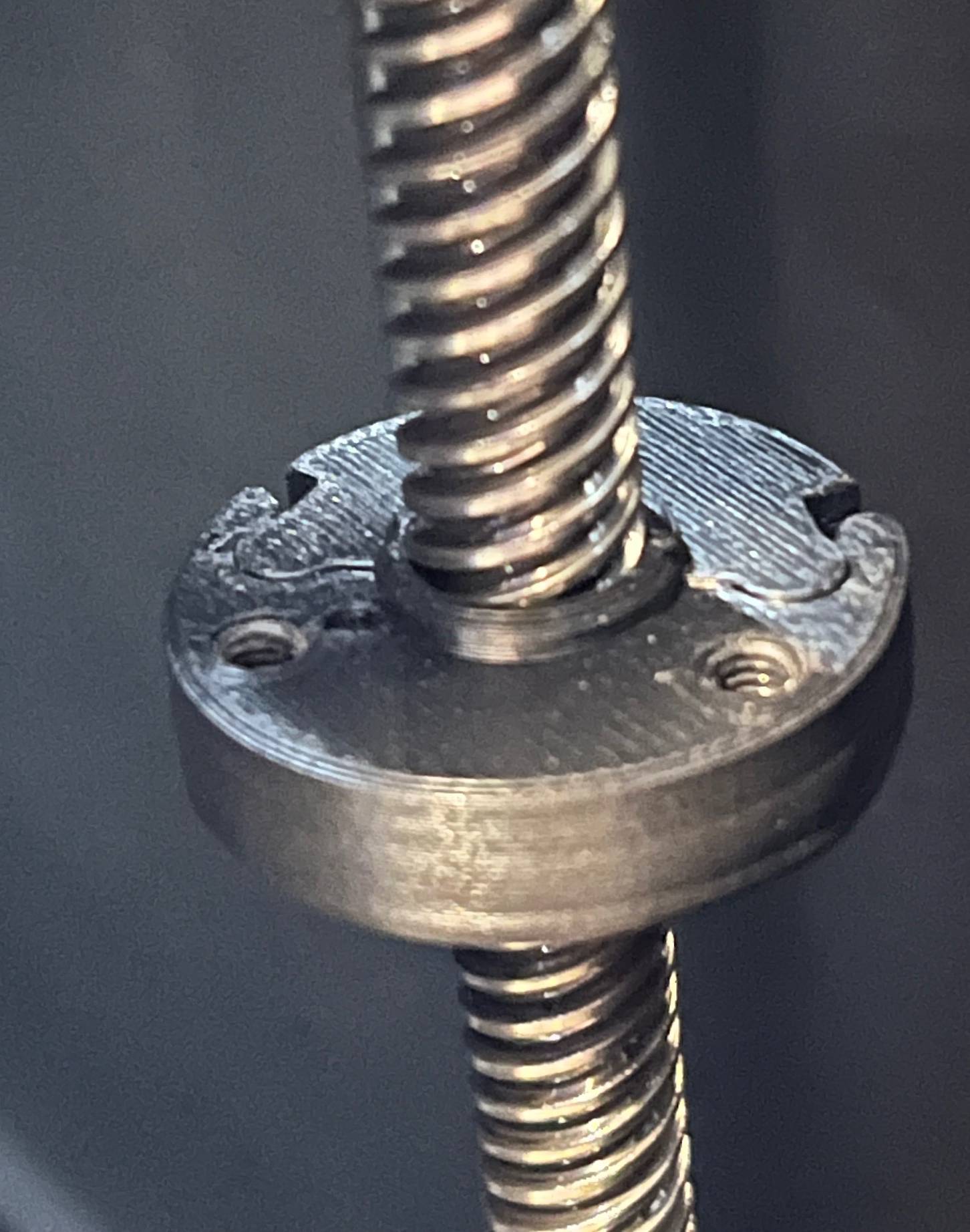

I will certainly do a proper topic for it but my leadscrew nut repair kit is now available on Makerworld.
It requires no disassembly, the rear nut is even possible from inside the printer (no need to remove the rear panel) and the best is the replacement of all 3 nuts requires less than 30 minutes (I did each front nut in less than 8 minutes, the rear in 13 minutes (the original screws were really tight :neutral_face: ).

I just can’t get my head around plastic nuts being better than the brass alternative, I’d want to see some serious hours built up on these to prove longevity which I am assuming you/others have done.
Prusa leadscrew nuts are POM and Igus has made a reputation in the industry making plastic leadscrew nuts. Of course, it’s not ASA (POM for Prusa, nylon or PC/PTFE for Igus) but plastic is not unheard of for this application.
How long the ASA nuts will survive, idk. I’m not a heavy printer so I may not be the first to comment on their in-servive life but given how they’re easy to replace, that’s not a big issue, they can just be replaced again in no time as an interim this time if they don’t hold just waiting for an original replacement.
Of course they can be made in other material, I just selected ASA for the reasonnable stiffness and strength and ease to procure and print. I actually have Igus filament I could try as its benefit is also to not require lubrication at all but I will leave the ASA nuts though to see how long they can survive :wink:

Reponding to my post :grin:. I replaced one of my front nut just to see how long it would take as the self tapping screws are a lot easier to remove than the loctite original metal screws and I also can now do it my eyes closed :grin:, I did replace it in less than 5 minutes
