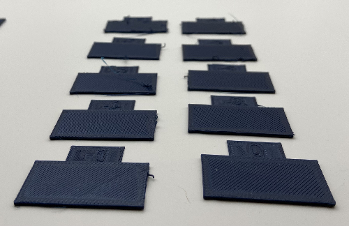

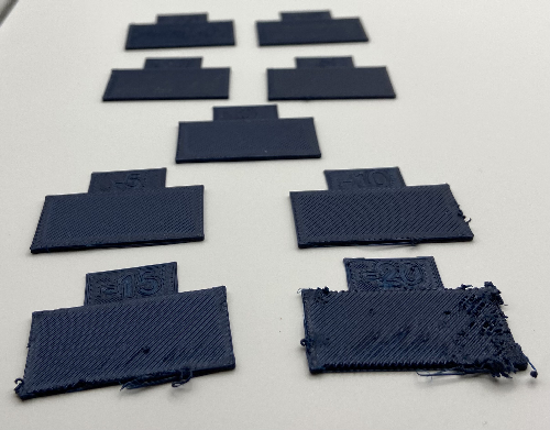

So sorry, thought I sent this lol. Until today, I had given up each time I failed on calibration prints. May have to do a couple posts for them, here is what it does with every calibration and every brand:
Here’s a simple multi test from Maker, that I tried yesterday:

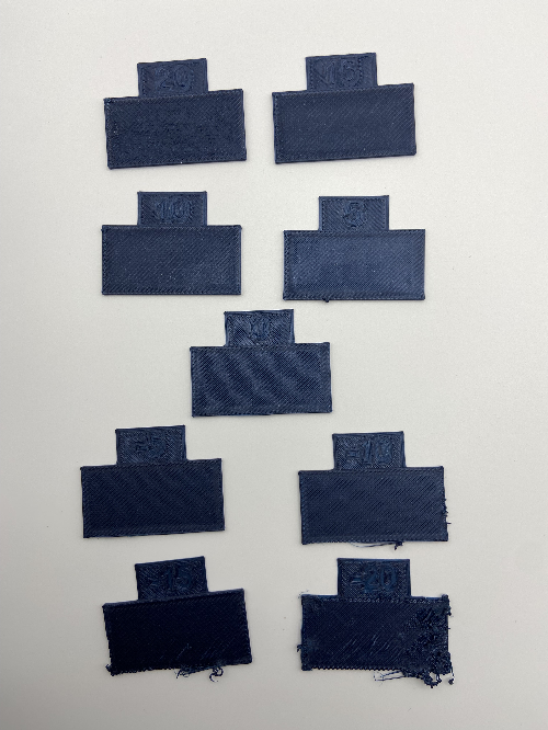

Then I tried avoiding cal tests with a new roll, undried, and just “Open in Bambu Studio”. Oddly it’s not awful, considering no cal or drying:
Then I did it again with the Overture Blue, that for was great, considering I haven’t calibrated:

My eye sight is getting real bad apparently… or your pictures are awfully small…
My guess is you have problem with layer adhesion, which is completely opposite of the benefit of PETG: strong layer bonding.

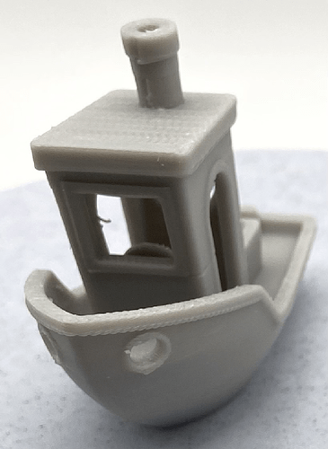

I have been doing some printing with the ancient PETG i found. It was still in its vacuum sealed bag, tight as a drum after nearly 7 years. Good packaging! Loaded it up and turned the P1S loose with it. A few artifacts and some stringing but for simple parts like boxes it’s fine.
Give it something more complex, though…
Could be the age, or just the material. The white PETG I bought in the same batch and used in 2018 also tended to look like this when I tried to do anything interesting with it. So I lean to just the material.
I stopped that print job, and then ran it again with Bambu Purple. So far, so good:
