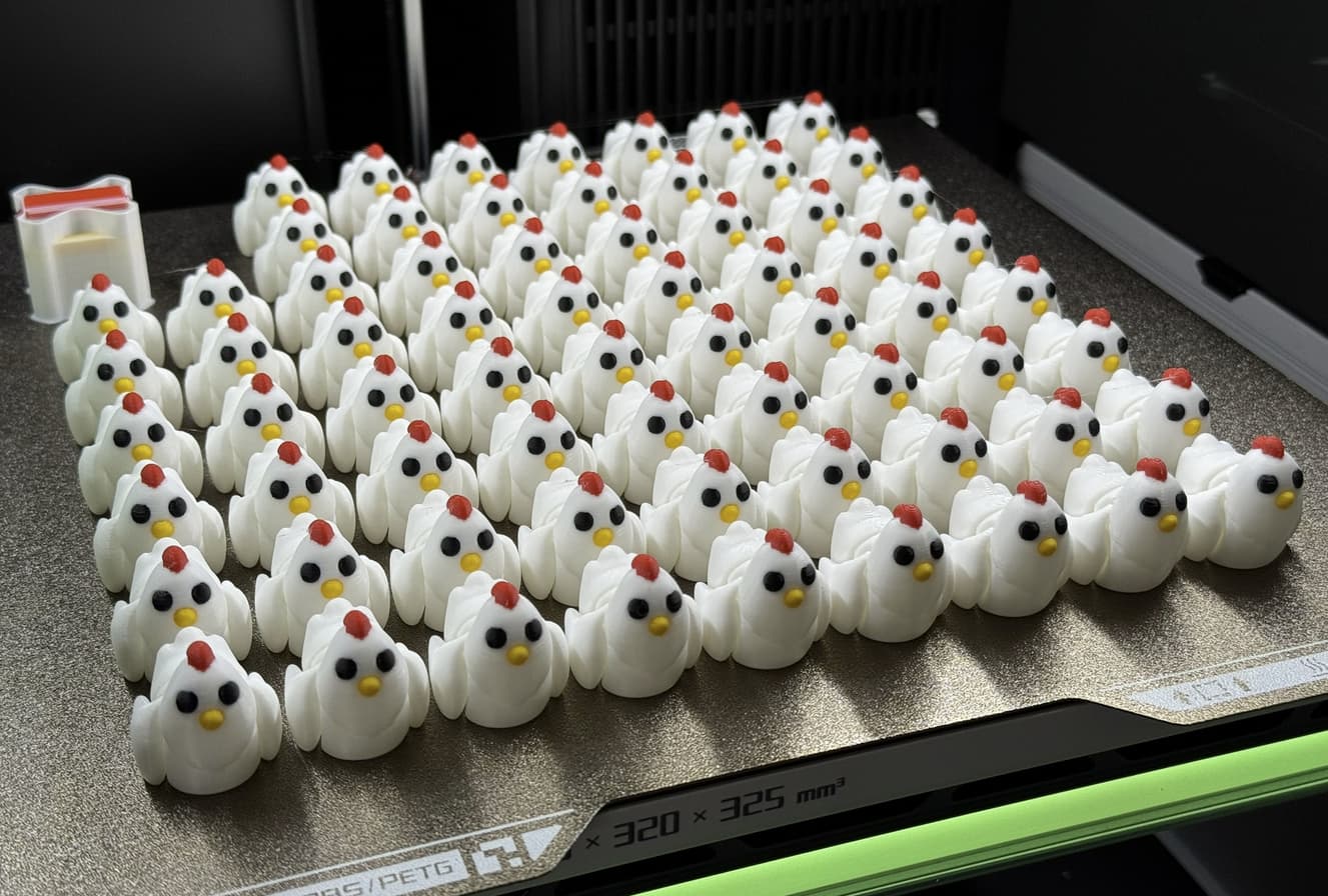

Also - you can fit more on the plate, so even if you do need to purge, it’s less purge per item if you fill the plate.
(I could have fit more on here)
