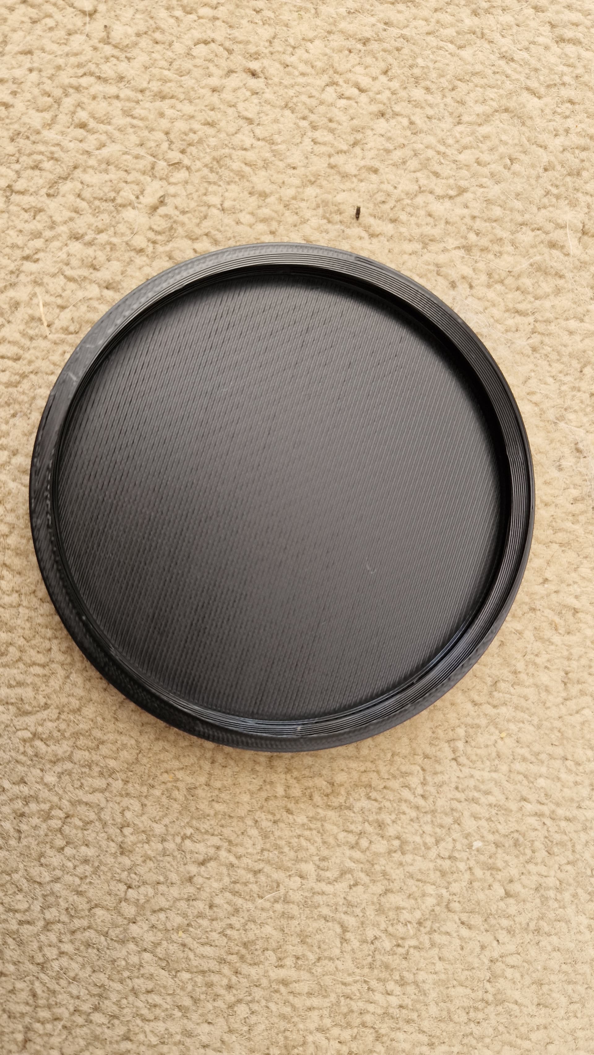

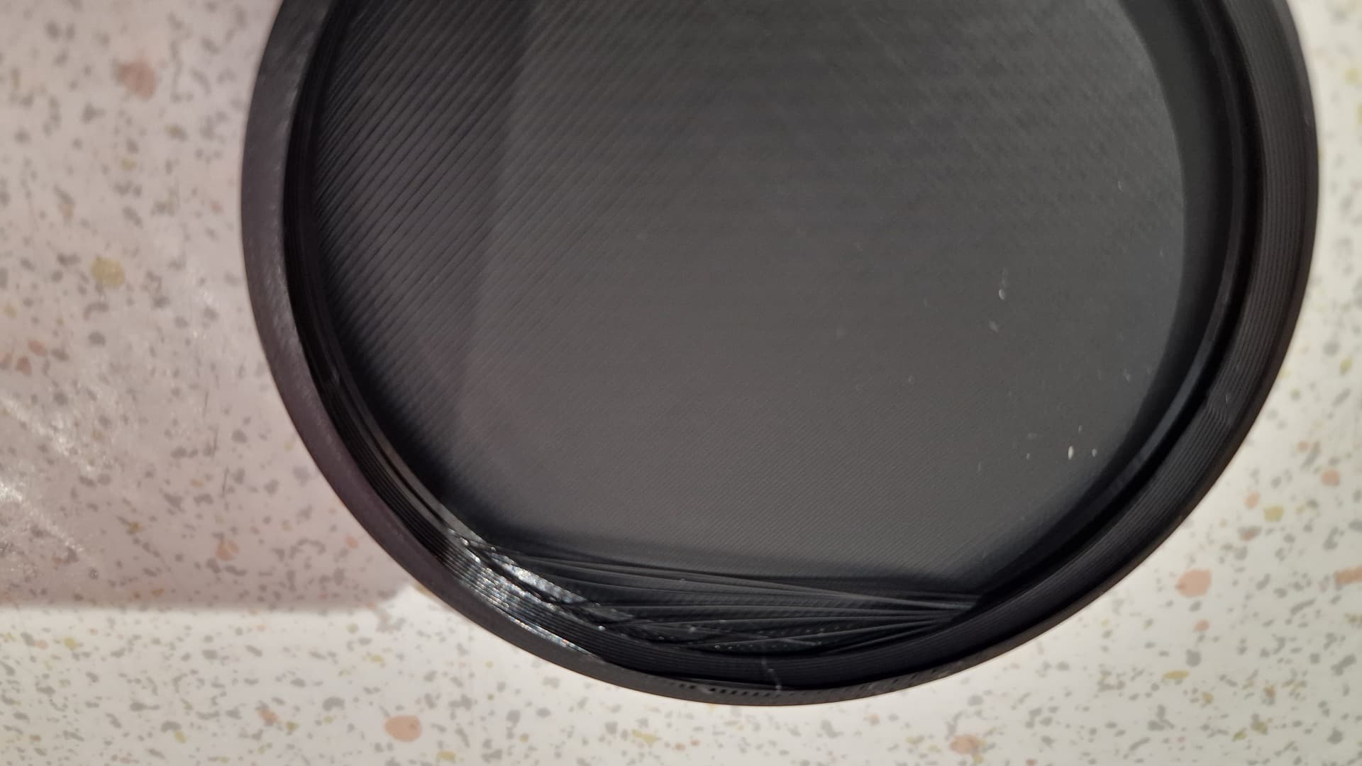

Hello, im currently dealing with support but iys slow going.
Im having general print issues with one of my X1Cs.
Im able to print this lid with the same roll of filament on the other machines, but on the printer with the issue, it doesnt quite make a circle and leaves some stringing, its like at a certain point, it cant quite make it.

Layer height @ 0.16 or lower usually works for threads
Thank you for the rraponse.
I orginally printed at 0.20 standard profile and the picture you see is a 0.16 fine setting, but the same file works perfectly on the other printers :frowning:
Ok well that’s unusual, what about wall order inside first? Other than that I’m out of ideas :slightly_smiling_face:

Maybe you have a little build up of carbon that might cause a tight spot. :man_shrugging:
Tha ks very much for the advice. I did this until my fingers were bleeding.

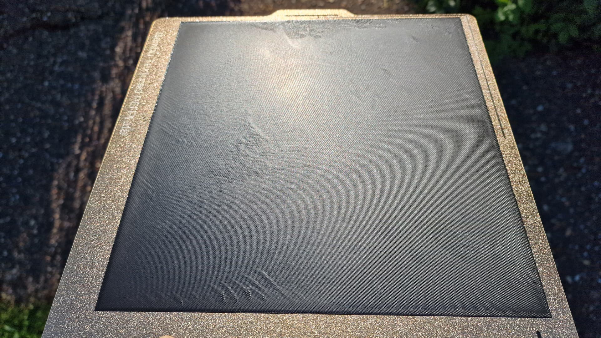

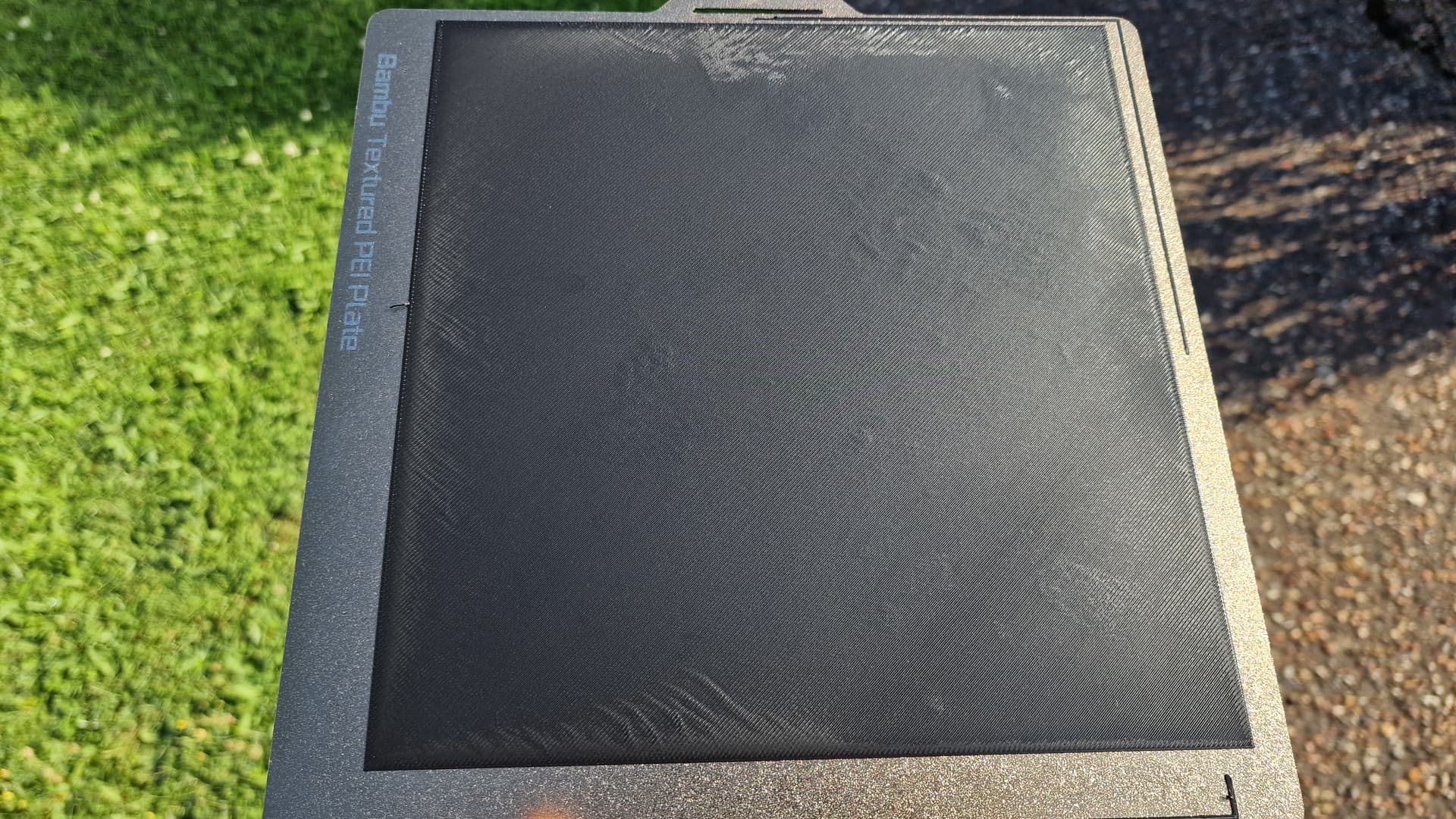

I have done the initial first layer test and have put the pictures here.

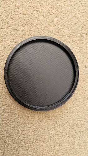

I also printed the same print on another X1C and it came out perfect (attched the picture for that too)
