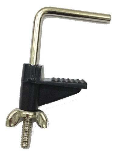

Hey everyone,
I am looking for these special clamps that sometimes come with product like pencil sharpeners or desk lamps, but I cannot for the life of me find them on AliExpress or Amazon or anywhere in a generic form:
I can find then as replacements made/sized for specific products, usually with extra plastic at the top that I do not want or need.
Really it’s just some kind of L-shaped bolt or machine screw with a wingnut and plastic part, but it’s difficult to find even the bolt alone. I also don’t want to print the plastic part if I don’t need to as then seems like it would already be a commonly manufacturer part and usually includes a rubber grip.
I am hoping to find a supplier that can offer them in 4in x 1in or 4in x 2in size.
Any tips would be much welcomed!

https://www.aliexpress.us/item/3256807487423303.html looks like it should work effectively the same as what you have in the picture?
I think what you shared a pic of though it not anything with a standard name - as far as I can tell it’s a customized F-clamp specifically made for pencil sharpeners
Is it possible to modify your product to use a more readily-available clamp type?

It actually is not too hard to use a cheap bolt of sufficient length, to bend it and to cut the head off.
Add a washer and wing nut and if need be a printed clamp to go on as well.
If the bolt dimensions are fixed even a hardwood board with two bolts for the bend and a little pipe will do fine.
If the DIY way is not feasible I can give you a hint: Anchor bolts :wink:
Looking for those gives you links to listings like this random pick.
L shaped bolts in various lengths and thread sizes.
Sure you still need to add a matching wing nut but they should be easy to find.
