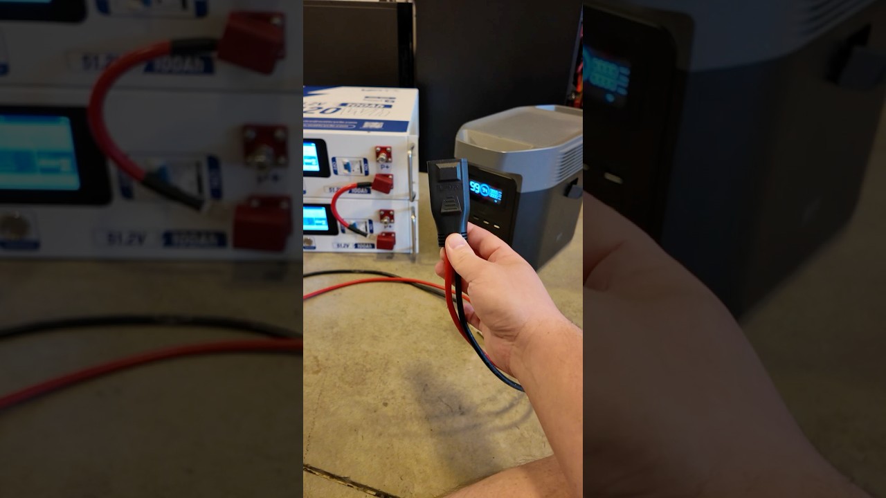

I use Pecron E3600LFP x2 for my workshop
I can hook 12 A1’s to each no problem with room to spare. The wattage as you print fluctuates between 50-200w so it handles it fine. I charge from the sun so I dont have a whole lot of context on UPS mode, but I do know that on shady days when I have it pulling AC, I hit the switch when im done, and the printers stay on. I imagine the same is in a power outage.
They are mildly noisy. Moderate idle consumption. Bad app but I dont use apps generally lol. They perform and I aint askin for much more out of them. When I did the research they were the best value per battery kwh which maybe isn’t the dimension you care most about.

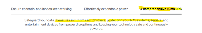

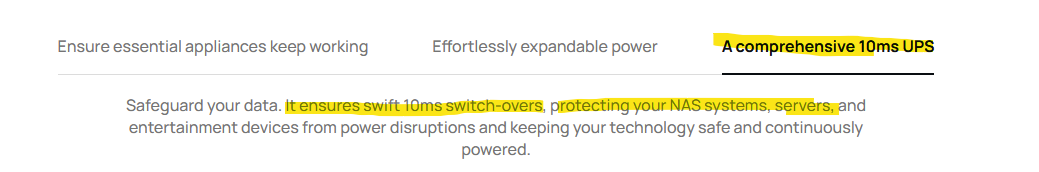

BTW I just double checked the specs, and the current wesbite does not claim the Delta Pro is usable as a UPS.
The “basic” Delta 3 however, is claimed to a UPS for NAS systems with a 10ms switchover time.

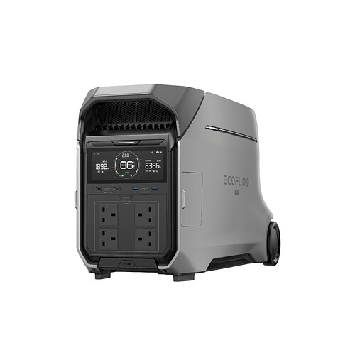

on delta pro 3 page, looks like it have a built-in UPS
I do not see that page on the UK spec
it’s possible it’s a different version in each country, or 240 vs 120 V differences?
In any case, if it does have a 10 ms UPS, it should work properly with mains powered equipment, since the power supply in a mains appliance is supposed to be able to hold up for 1 missed AC cycle, or around 15 ms.
I wonder if maybe Bambu isn’t following that (because it’s niche equipment and not a PC), or there is some issue with the UPS design?
