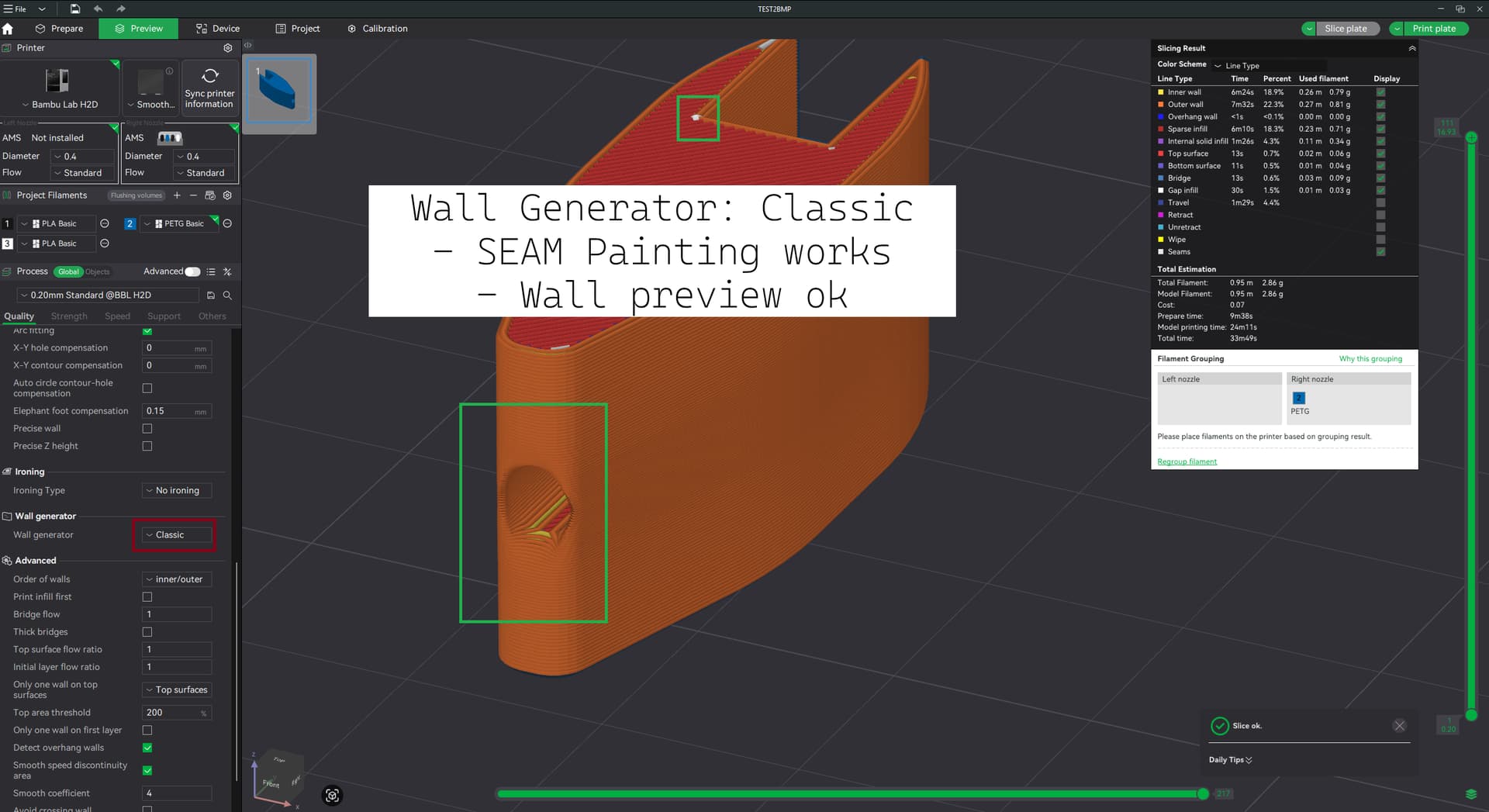

  1. In Bambu Studio, Z-Seam Painting is ignored as soon as Arachne mode is selected.
  2. With Bambu Studio, the contour calculation is really messy, which leads to grooves and unclean printing as soon as Arachne mode is selected.
Proposal: Do not use Arachne → Classic Wall Generator works
Solution: Patching
Example:
Here is an example of a manually painted z-Seam body. 0.2mm standard profile. The Z-Seam was placed in the hole and in the inside of the groove on the back of the body.
In Classic mode, the Z-Seam is placed as it should be.
In Arachne mode, the Z-Seam is placed towards the front.
This results in gaps and unclean calculations of the contours.
